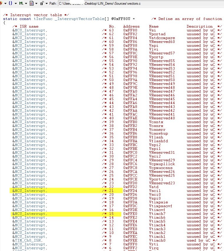

I create the LDF and NPF files, then generate the configuration code about lin_cfg.c, lin_cfg.h and lin_hw_cfg.h. I also move the LIN_Stack into my project as shown below. How many interrupt functions are there? How can I add these interrupt functions to interrupt vector table in vector.c file? The MCU is MC9S12G128 and the development environment is CodeWarrior 5.2. Please give me some support. Thanks!

jeffcharles
Hi Jennie,
I don't use the demo code in the FSL_LIN_2.X_STACK. I just want to know how many interrupt functions are in the stack so that I can add them to interrupt vector table. My project is in the attachment, please help me to check it. Thanks!
2,154 Views
ZhangJennie
check your map file:
we can see above two interrupts conflict with the vector definition in vector.c .
In vector.c. these two vectors are also defined:
Please adjust your code. in one project, only one vector table can be used.
Jennie Zhang

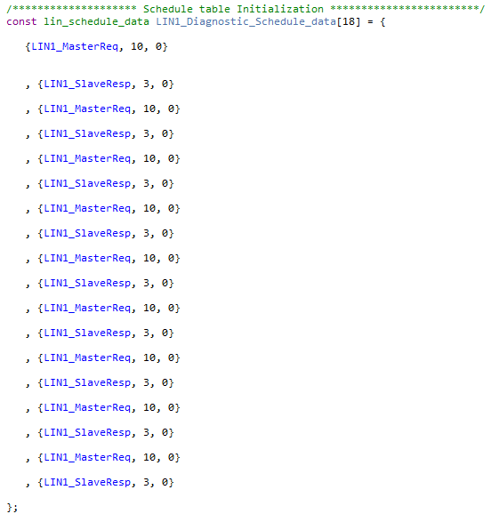

jeffcharles
Hi Jennie,
As a master, I want to send some diagnostic frames to the slave. My diagnostic schedule is like that:
The time base is 5ms, so the MasterReq is 50ms delay and the SlaveResp is 15ms. I try to call the ld_read_by_id function, and the code is like that:
I can't find the 0x3d frame from the CANoe. What is wrong with it? Please give me some advice, thanks!

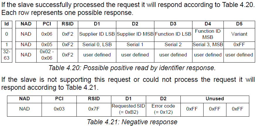

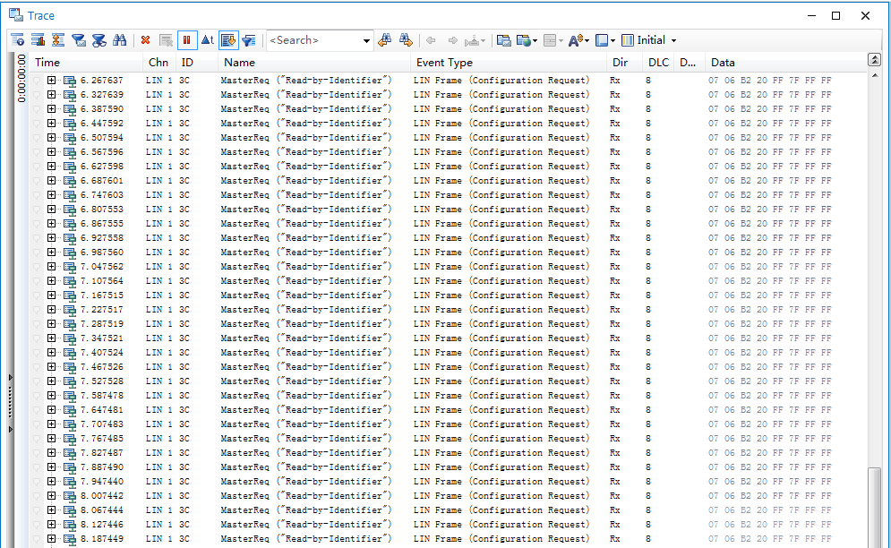

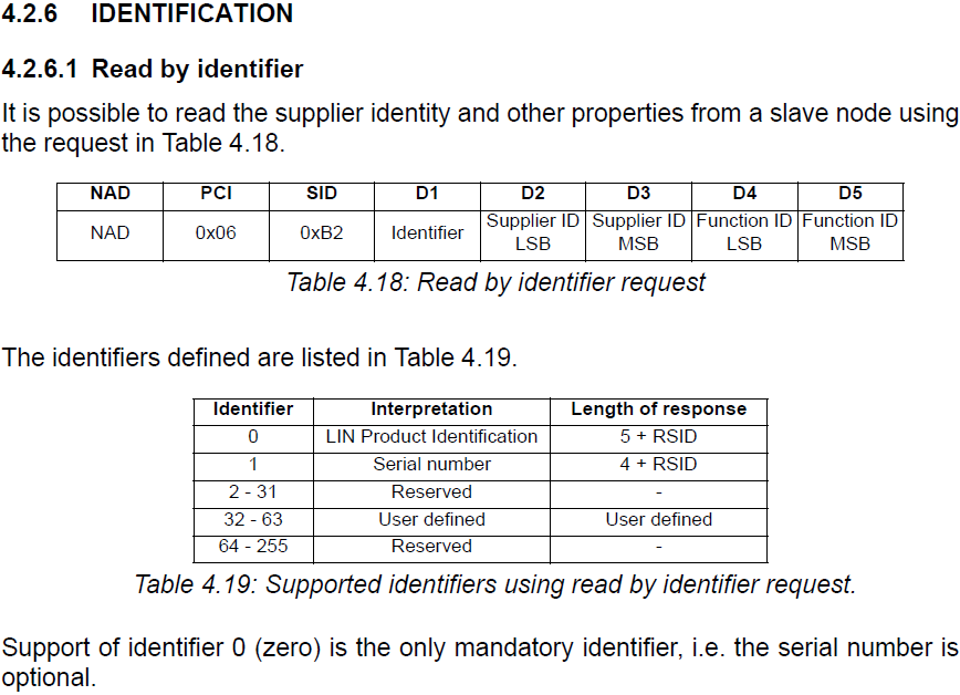

jeffcharles
Hi Jennie,
They are diagnostic frame, 0x3c is master request frame and 0x3d is slave response frame. I want to use the read by identifier service. So I send 0x3c request to the slave firstly, then send 0x3d frame header and wait for the slave reponse.
The request format is according to the chapter 4.2.6 in LIN2.2A. But the 0x3d header can't be send successfully.
