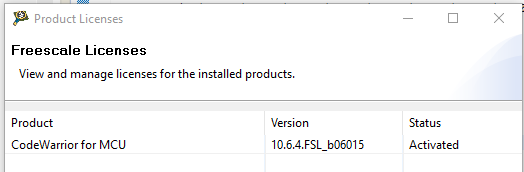

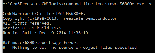

More information about the compiler version and a test routine:
typedef long frac32_t;
frac32_t x_invert(frac32_t in)
   return(~in);
volatile frac32_t xx_inv;
void APP_Task10ms(void)
   xx_inv=x_invert(0x80000000);
Result:
