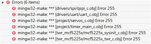

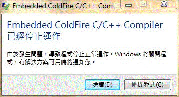

Hello ,
Not sure what's wrong with CW10.2 to have error messages as attached.
Even we uninstall and reinstall CW10.2.
Same codes were successfully compiled before by same CW10.2.
Wondering if some changes of environment settings we have accidentally triggered to get into the problem?

MangoBot
Hello  Erich ,
It's already English mode, same error messages.
Found no .obj files generated to get into make error. Probably something's wrong with compiler path/settings.
Odd, uninstall/reinstall can't resolve it!

mingw32-make: *** [twr_mcf5225x/mcf5225x_sysinit_c.obj] Error -1073741811
mingw32-make: *** Waiting for unfinished jobs....
mingw32-make: *** [project/servos_c.obj] Error -1073741811
mingw32-make: *** [drivers/spi/qspi_c.obj] Error -1073741811
mingw32-make: *** [drivers/uart/uart_c.obj] Error 255
mingw32-make: *** [project/timer_main_c.obj] Error 255
mingw32-make: *** [twr_mcf5225x/mcf5225x_twr_c.obj] Error 255

MangoBot
Should be no Cygwin.
We did four tests :
A. Install update 1.0 to CW10.2
     1. compile project
     2. import old .mcp project and compile
     3. compile example project in "CW MCU v10.2\MCU\CodeWarrior_Examples\ColdFire_Examples"
B. Uninstall CW10.2, install CW10.1
     4. compile project
All failed in same stage with same error messages.
Wondering if CW10 has some pitfalls in WIN7 system.

MangoBot
Try new project by wizard, turning off firewall/anti-virus, running with administrative rights.
No good news, same errors still.
