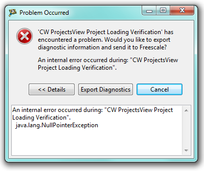

Hello, I'm getting this error:
Steps to reproduce:
1. Open CW v10.5
2. Create a new project for QG8 using Processor Expert. I tried SE8, PA60, QE8 and they work good, so it MUST be QG8 with Processor Expert.
3. Restart CW.
Now CW starts slow with a lot of CPU activity and shows this error.
Workaround:
1. Open the ".cproject" file inside the QG8 project folder.
2. Search and delete the string: parallelBuildOn="true"
3. Restart CW.
Everything works fine now.
Hope someone finds it useful.

Definitely useful!
I tried this one on my side (MCU10.5, QG8 with Processor Expert), and I'm not seeing that issue.
Good for me ;-), but I really want to find out on my side what is going on.
I have parallel build enabled, btw.
Any thoughts?
I'm using Win7 64bits.

I had now the same problem on my machine. And the reason was clearly a mal-operation on my side: I loaded a 10.5 project with 10.4 (which is a bad thing, as Eclipse projects are not backwards compatible) by mistake. Then when Ioaded that 'downgraded' project in 10.5 again, I saw this error message.
Could it be that you did the same mistake?

I'm honestly not sure at this point. I haven't seen the issue since I first installed 10.5 and I haven't used 10.4 since then.
