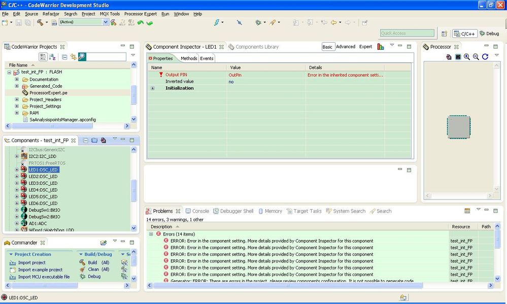

ZhangJennie
just open your project with CW10.5.
it appears some compoents ( DSC_LED ) in your project doesn't support  with CW for kinetis.
see attached. can you please check the same

bowerymarc
Contributor V
Hi Jenny,
I guess you don't have Erich Steyger's 'mcuoneclipse' PE library installed.  Anyhow it's not important, you can just delete any of the PE components that aren't working, they aren't used for this test anyhow.
