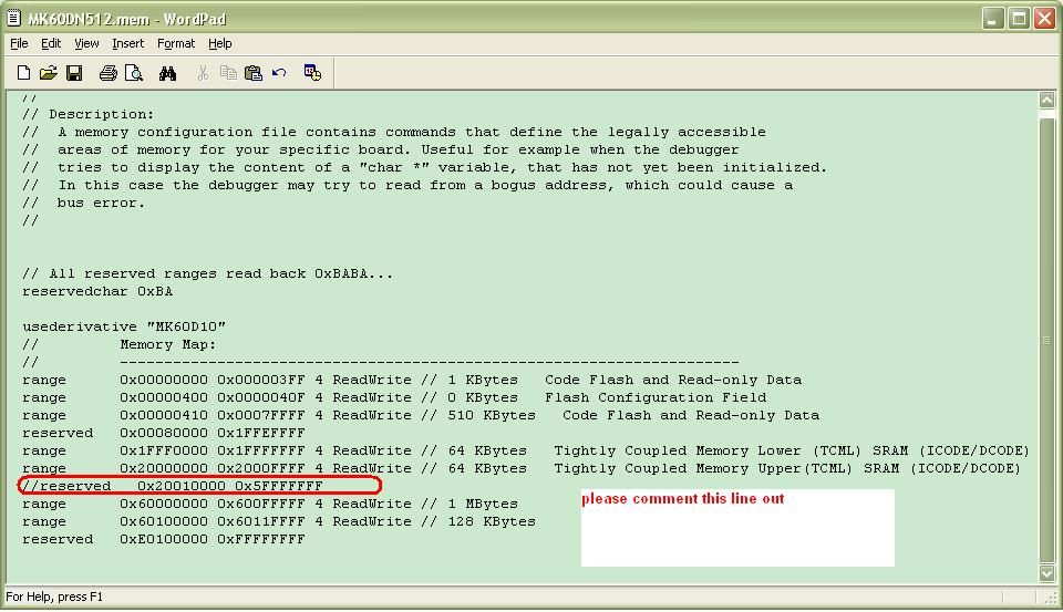

When I try to debug with my program and the file tries to download to my PnE U-MultiLink, I get the following error message:
"There was an error parsing the memory configuration file:
Reserved range 0x200100000:0x5FFFFFFFF overlaps with Reserved
range 0x40000004:0x4000001F"
The .mem file looks like this:
usederivative "MK60D10"
//         Memory Map:
range      0x00000000 0x000003FF 4 ReadWrite // 1 KBytes   Code Flash and Read-only Data
range      0x00000400 0x0000040F 4 ReadWrite // 0 KBytes   Flash Configuration Field
range      0x00000410 0x0007FFFF 4 ReadWrite // 510 KBytes   Code Flash and Read-only Data
reserved   0x00080000 0x1FFEFFFF
range      0x1FFF0000 0x1FFFFFFF 4 ReadWrite // 64 KBytes   Tightly Coupled Memory Lower (TCML) SRAM (ICODE/DCODE)
range      0x20000000 0x2000FFFF 4 ReadWrite // 64 KBytes   Tightly Coupled Memory Upper(TCML) SRAM (ICODE/DCODE)
reserved   0x20010000 0x5FFFFFFF
range      0x60000000 0x600FFFFF 4 ReadWrite // 1 MBytes
range      0x60100000 0x6011FFFF 4 ReadWrite // 128 KBytes
reserved   0xE0100000 0xFFFFFFFF
I don't see the problem.  Are there any ideas?

Actually, Ma Hui's suggestion is partially correct.  It seems to me that commenting out the reserved area was a work around for the .mem file that processor expert created.
The 1M of memory was defined in processor expert as external ram on the FlexBus.  I did not want to copy flash to external ram, but I could not find any way to prevent it in processor expert.  To "fix" the problem I needed to modify the "ProcessorExpert.lcf" file.  After a bit of trial and error, the project seems to build and debug.
Unfortunately, when I change anything that requires running processor expert, I must change the files back to their modified state.
Changing the ProcessorExpert settings to not make the .mem file seems to delete the file and the project cannot build.
I hope this helps.
Don

unfortunately, it's a bug in Processor Expert.  It will be fixed in the next CodeWarrior release.
The workaround is to comment-out the line (as it has been described) after each code re-generation.

dporada
Sorry, this doesn't help.
Unless I'm doing something wrong, if I don't modify the .mem file, I get the error shown above.  If I don't modify the link file, the program tries to do a copy to the external memory to initialize it and I get an error saying that I don't have enough memory.
Every time I change a setting with the flex bus settings in processor expert and rebuild, I must modify both files.  I've gotten to the point where I leave a modified copy of the link file up and after rebuilding the project, I paste it into the new link file.

In SR:1-1179667447 the debugger problem fixed way is:
The project application can be programmed when comment “reserved 0x2001000 …” in the <MK60DN512.mem > file.
This <MK60DN512.mem> file is located in {PRJ}/Project_Settings/Debugger/ folder.
More detailed info, please check attached picture.
And In SR: 1-1179667447, the customer want to store 1M bytes data to Flash memory(after chip boot, copy to external RAM), which exceed the Flash size cause the problem.
Customer need to check data memory size not to exceed internal Flash memory size.
Wish it helps.
