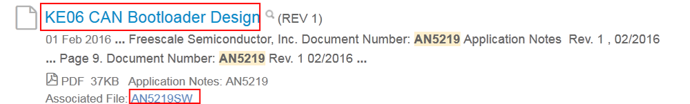

    How to do a Bootloader for KEA-128?
1,715 Views
Hello VIGNESH,
About make a bootloader about KEA-128, i think you can refer to this thread :
Re: Boot TRK KEA128 via UART
Hope it helps

Hi Alice,
Is there anything any document or posts or example code for
CAN Bootloader
On 16 Feb 2016 7:41 a.m., "Alice_Yang" <admin@community.freescale.com>
1,714 Views
There is a CAN bootloader about KE06,  ke06 almost is the same with KEA128, you can refer to it .
Search Results: AN5219
It include the code and document .
Hope it helps
Alice Yang

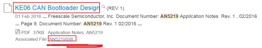

Hi Alice,
              Can you provide me the link for the code that wass suggested to use in the document???
1,715 Views
Hello VIGNESH,
Please click the AN5219SW. the code will show .
Alice
