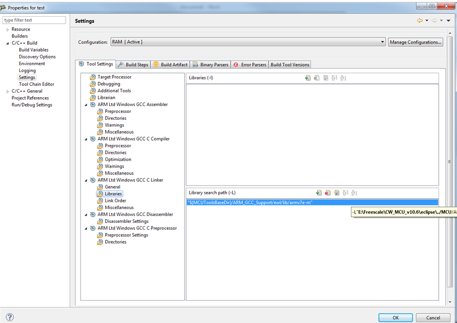

The library is defined in the linker settings
I've created the project via the wizard.

johnstrohm
Picture too small to be readable.
It is our understanding that the wizard only knows how to create C projects, and we're doing C++.

johnstrohm
That's the library path setting I am currently using.
The problem is with libgcc.a.
The linker is pulling libgcc.a from:
     c:/Freescale/CW MCU v10.6/Cross_Tools/arm-none-eabi-gcc-4_7_3/lib/gcc/arm-none-eabi/4.7.3
This is the wrong place for an ARM Cortex-M4.
It should be pulling it from:
     c:/Freescale/CW MCU v10.6/Cross_Tools/arm-none-eabi-gcc-4_7_3/lib/gcc/arm-none-eabi/4.7.3/armv7e-m/
My libpath settings are essentially identical to yours:
