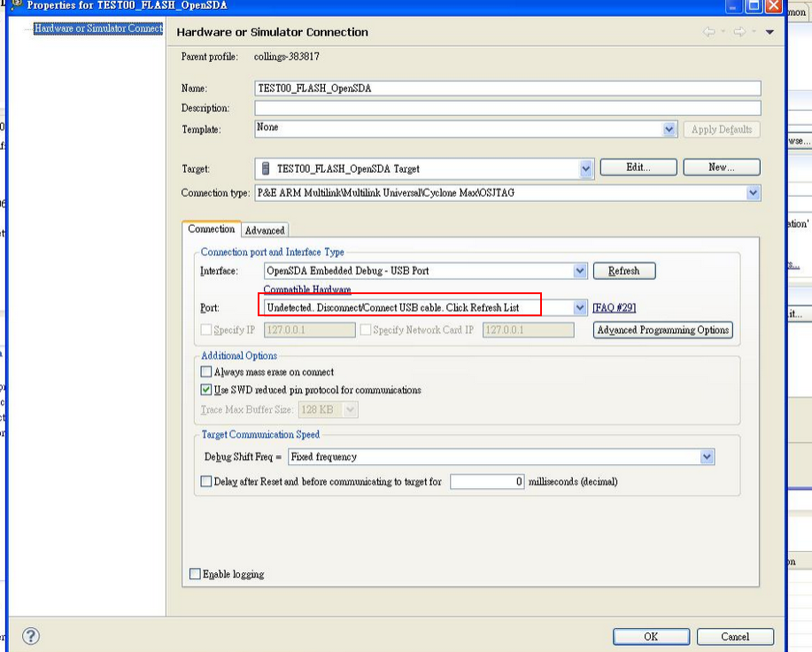

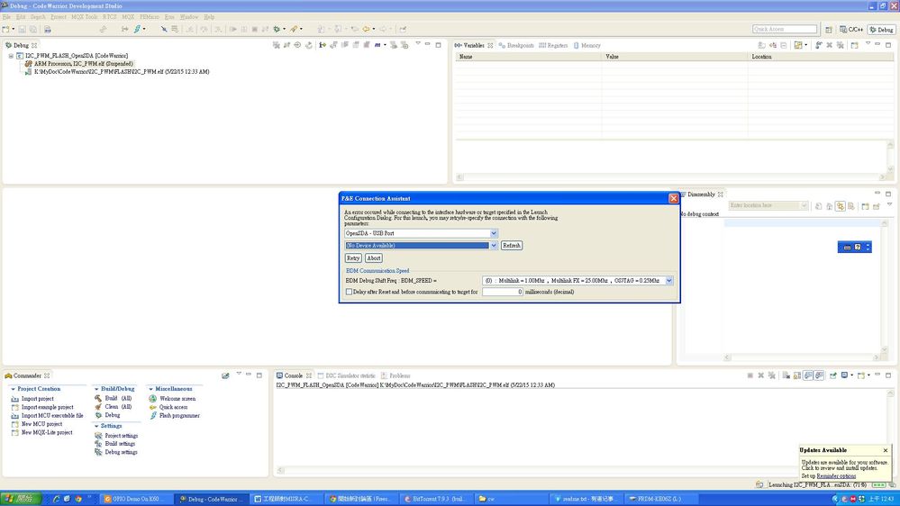

  2. I dont know why it always show NO Device Avaliable?
  3. How should I set to connect to FRDM-KE06Z?

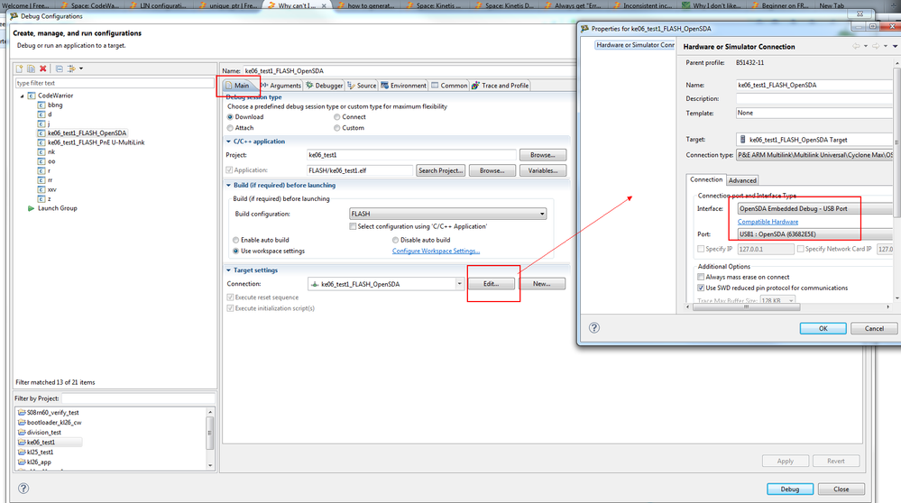

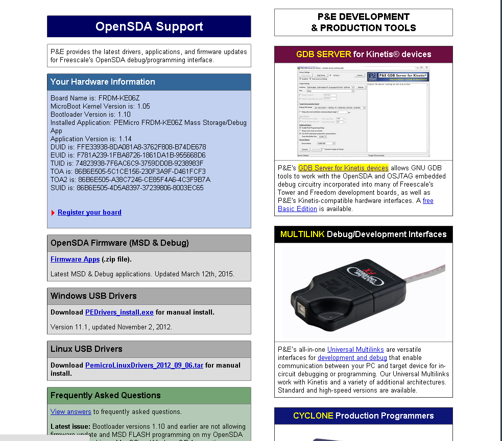

Hello
After you connect your board , please check here :
if it is the same with mine , it is right .
Then when debug , check here :
If the two place is different form mine , please show yours , and tell me your PC version , win7 or XP , or else ?

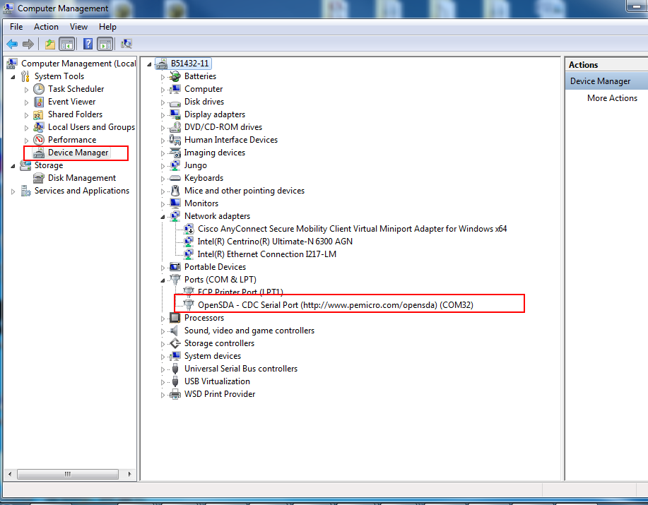

修華許
I am not very sure the driver, this is my OpenSDA information
2,411 Views

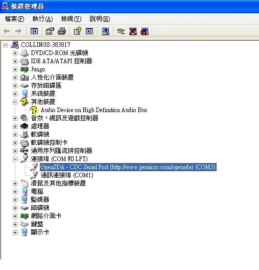

Hi ,
From the screenshot of your Device Manger screen , it show the driver have been installed correctly.
While From your screenshot , it have not connected the board :
So update the bootloader  , do refer to this steps :
then copy and paste the "MSD-DEBUG-FRDM-KE06Z_Pemicro_v114.SDA" to the bootloader drive .
Then unplug the USB cable and plug it in  again. Then test .

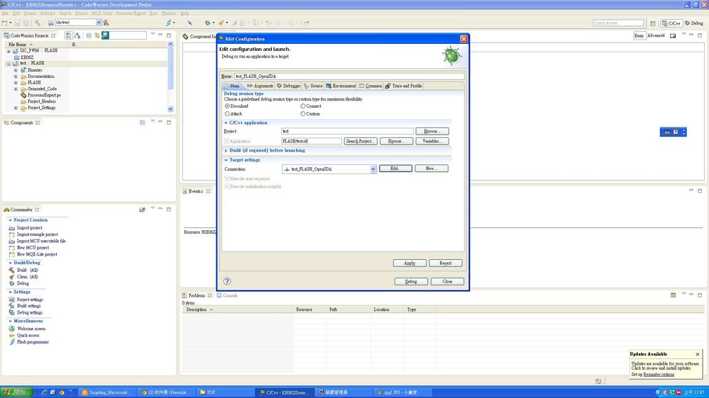

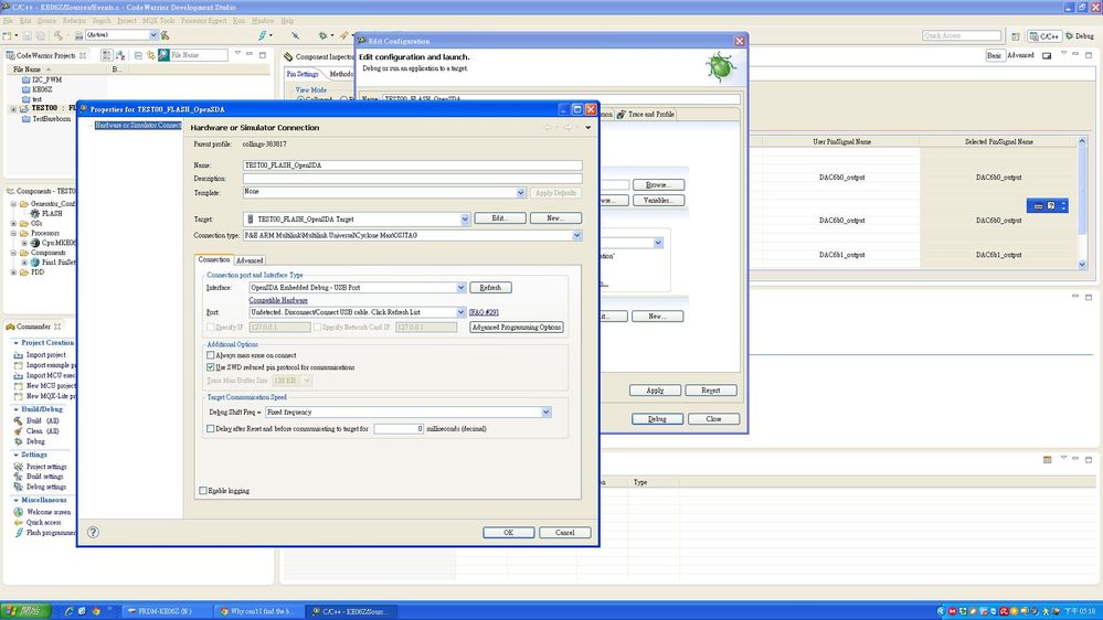

修華許
Thanks for help .
I am a newbie for freescale MCU. So I am not sure I did the right thing to build your project.
I just drag and .project file to codewarrior .
And press Build All / Then Deubg
still the same problem :smileysad: No idea why?
And one thing to ask ,  I found that the project I build has the word "FLASH" near the project name, is that normal?
I guess my problem is related to Driver, But I have uninstall and reinstall . Still the same
