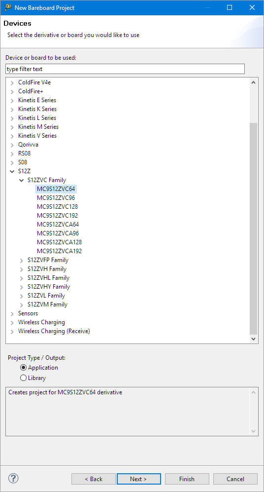

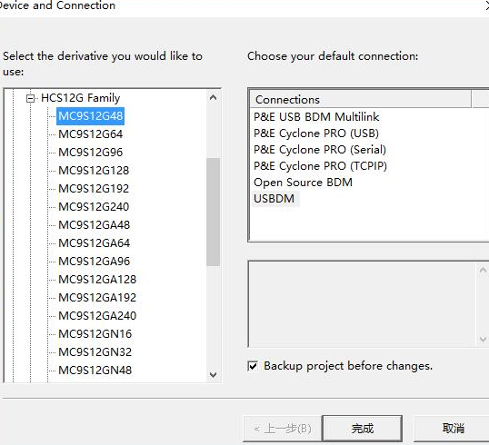

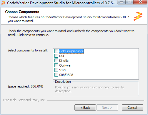

Hi Erich Styger,This offline package contains all architectures supported (ColdFire, ColdFire+, S08, RS08, S12, S12/XGATE, S12Z, DSC, Qorivva, Kinetis)?
I want to add same S12 derivatives (For example,MC9S12G48).What do I need to do?

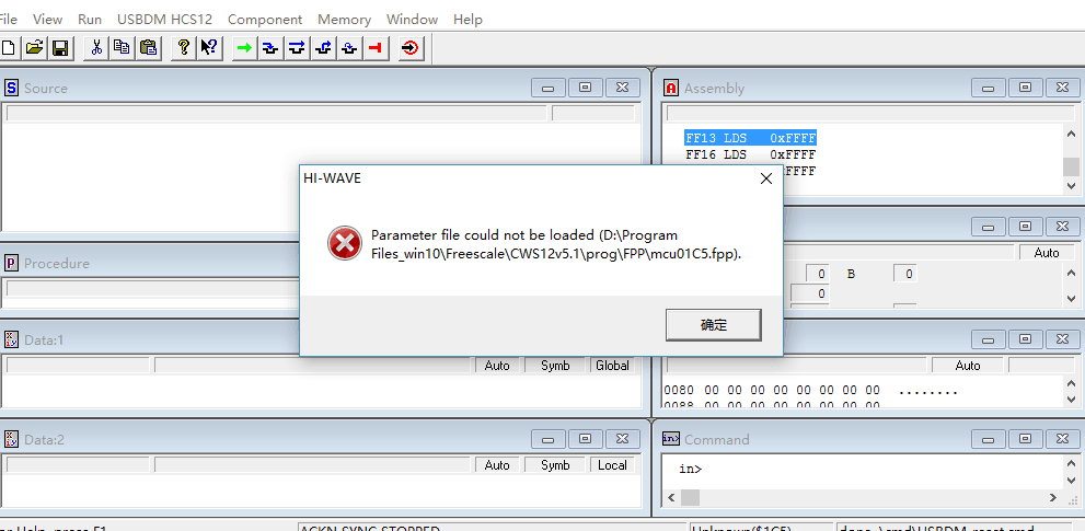

I need to use USBDM,but CodeWarrior5.1/5.2 don't support it.
yes, the offline package contains all the architectures shown in your last screenshot. So it supports the S12Z, and *not* the normal S12 you are showing in your previous screenshot:
If you want to use S12, you have to use Codewarrior (classic, not Eclipse based) 5.x. And yes, USBDM is not included in that installation, but I think you can add it (refer to the USBDM pages for this).
I hope this helps,
Erich
