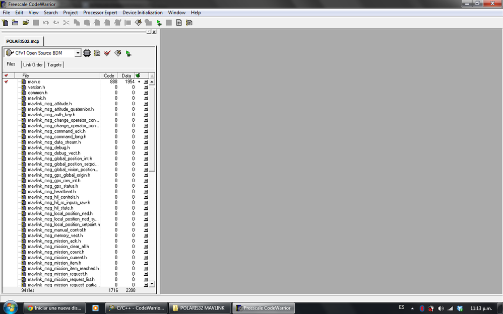

Hi!  i been trying to use Mavlink headers into my project, based on MCF51JM128 microcontroller.
here's the webpage for this development:
http://qgroundcontrol.org/mavlink/start
following instructions from this page:  http://qgroundcontrol.org/dev/mavlink_onboard_integration_tutorial i tried to include all necesary headers to my project.  as i couldn't add them as a folder to search into, i'd to add each header for this project, by hand.
this is how it looks adding all headers by hand.  any way to add them as they come in the original project, within folders?
bases on examples of Mavlink, i called a function mavlink_msg_heartbeat_pack(), supposed of charging some information to a comm buffer.11097_11097.pngImagen2.png

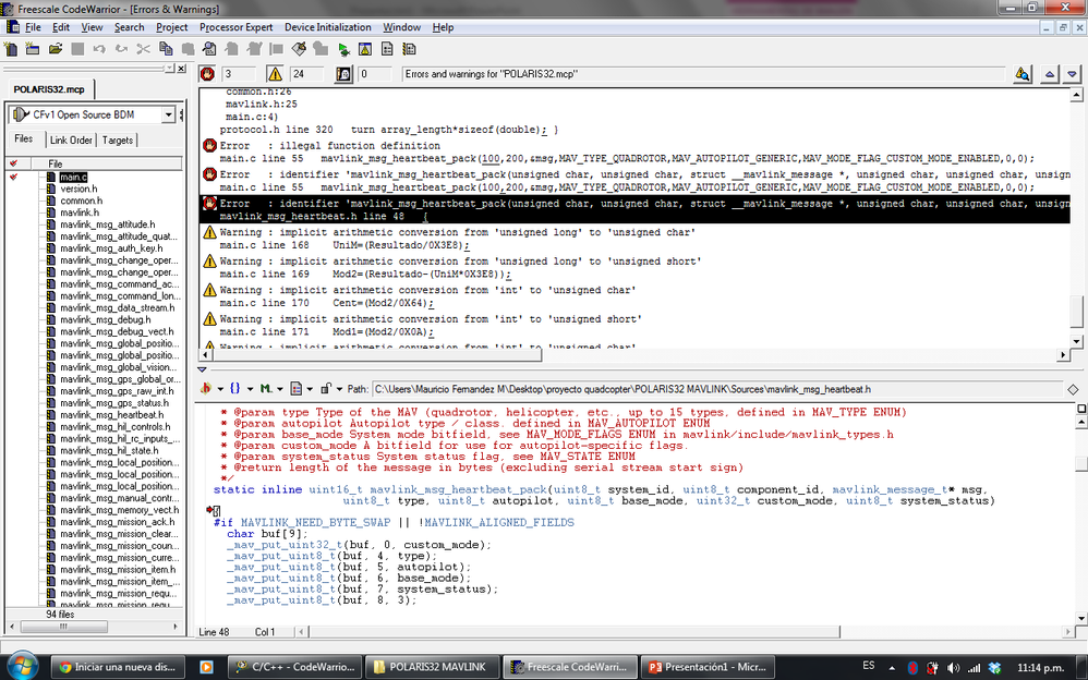

  trying to call a message routine from a header, i got this error messages:

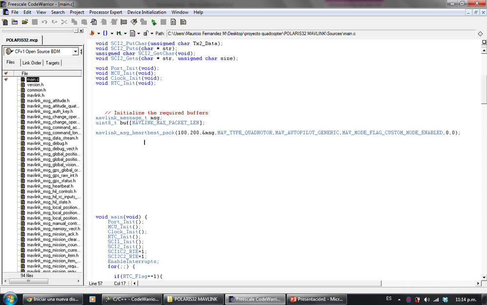

No you didn't. You wrote what the compiler thinks is a function prototype for mavlink_msg_heartbeat_pack(). Note that what you wrote on line 55 is outside the scope of any function, before you start your definition of main(). It is therefore going to be interpreted as a definition or declaration, (a function definition or function prototype). But it is not a valid definition or declaration because inside the parentheses are actual parameters (literals like 100, 200 and MAV_TYPE_QUADROTOR).
The first error that you got therefore says "illegal function definition", and is correct.
In C you can't have executable code outside of a function. To fix the error, move those three lines of code into the body of a function (e.g. move them somewhere inside main()).
