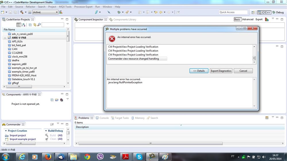

My project was running ok. Suddenly, when I open Code Warrior 10.5, it pops us the following message:
And since then, I just can't open the project anymore. When I close a message, another one comes up, and this never ends. It is curious that this happens with only one project in my workspace. The other project can be opened without problems. I couldn't identify the reason for that. Probably, one or more files might be corrupted, I don't know.
Did anybody face such a problem?

It might be something with the parallel build settings?
Can you try the fix mentioned in CW ProjectsView Project Loading Verification Internal Error

I just tried it and worked perfectly.
The doesn't ocurr only with QG8. In my project, I used MC9S08PA8. It seems like a kind of bug in Code Warrior v. 10.5?
I hope that was solved in Code Warrior v. 10.6.
Thank you very much!
