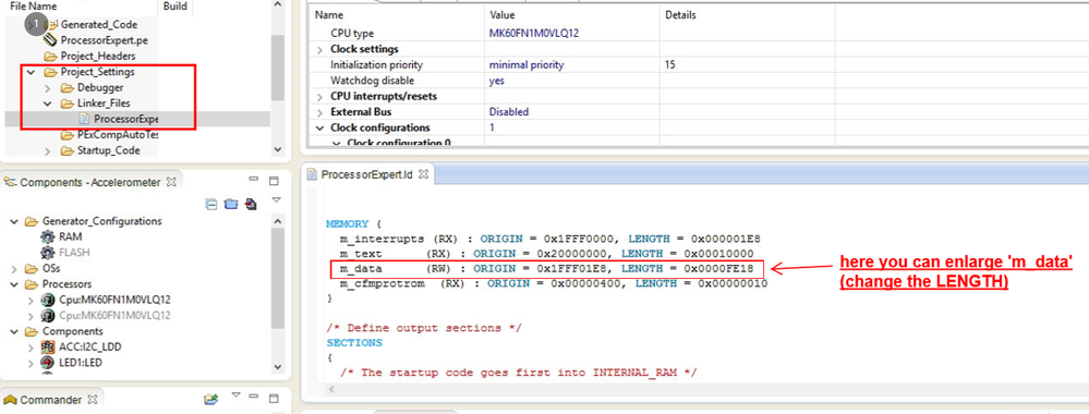

Hi all,
i have a qeustion. Maybe somebody can help me.
I wrote an algorithm in the language C. My algorithm create a random labyrinth. I used the function "srand((unsigned)time(NULL));". With this function i ensure that my labyrinth is really random (otherwise i get always the same labyrinth, for more information about "srand((unsigned)time(NULL));" see srand - C++ Reference ).
Additional i add the Header file " #include<stdlib.h> " and " #include<time.h> ". Now i can use the function srand(.......).
If i build my algorithm in Microsoft Visual i get no problems.
But if i copy my algorithm in CodeWarrior and build it then i get the problem report " undefined reference to `time' ".
But i used the header file time.h and in microsoft visual it works.
Have anybody an idea why i become this problem report in CodeWarrior, and what can i do?
Thank you very much!

Hello Armend,
I have checked your project, the root reason is the code overflowed .
For the chip of MK60FN1M0 only have 128K SRAM, while your m_data is 550416 bytes, it is 537K .
You can relocate the large data to FLASH, refer to this DOC :
Relocating Code and Data Using the CW GCC Linker File for Kinetis
Hope it helps
Alice

armendgecaj
Hi Alice,
i forget to tell you that if you build my project you will become a "overflowed-problem"
But i already fixed this problem. If you go to Project_Settings --> Linker_Files --> ProcessorExpert.Id, you can enlarge 'm_data'.
Only changing the LENGTH of 'm_data' and the "overflowed-problem" will be fixed (see the image i attached)
But have you any idea how to fix the problem: 'undefined reference to time'. This is coming from the function 'srand((unsigned)time(NULL))'.
I find this post: "The CodeWarrior libraries provide the time functions as are standard but these does not come with the low level functions for the operations, as stated on the MSL C reference manual".
I understand it but what have i exactly to do now to fix the problem.
I would be grateful if you (or somebody else) give me a hint.
Best Regards
Armend Gecaj

armendgecaj
Hi Alice
You asked: "[...], so how length do you can change to meet the 537 KB?"
Well, i enlarged 'm_data' from LENGTH = 0x0000FE18 to LENGTH = 0x000AFE18.
If i do that then the overflowed-problem will be fixed.
The post about the header file "time.h" is here: How to use clock_t with time.h header file
But i do not really understand what this user is trying to say.

Hello Armend,
1 . It means there is no driver for the function of time , you need write the function specific to your device .
"The ANSI library provides several functions to get the current time. In an embedded systems environment, implementations for these functions cannot be provided because different targets may use different ways to count the time."
2. About the SRAM memory , even through  after you change the length , there is no error when you build ,
while this is still can not run correctly , for the mcu only have 128K SRAM,  if the data bigger than that , where does the data placed ?
Hope it helps
Alice
8,836 次查看
armendgecaj
Hi Alice,
Ok now i understand. I need to create a Driver to use time (for 'srand((unsigned)time(NULL))'). Thank you.
To the second point (SRAM Memory) you are right. Even if i change 'm_data' so that i get no error message, it does not work.
But i have fixed this problem already. I have changed my function a little bit.
Best Regards
