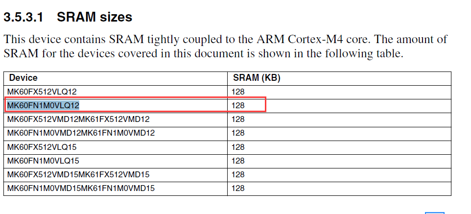

I have checked your project, the root reason is the code overflowed .
For the chip of MK60FN1M0 only have 128K SRAM, while your m_data is 550416 bytes, it is 537K .

Hello Armend,
- The maximum size of the RAM about the chip of MK60FN1M0VLQ12  is 128KB 。
While from the  m_data is 550416 bytes, it is 537KB, so how length do you can change to meet the 537KB?

Well, i enlarged 'm_data' from LENGTH = 0x0000FE18 to LENGTH = 0x000AFE18.
If i do that then the overflowed-problem will be fixed.

2. About the SRAM memory , even through  after you change the length , there is no error when you build ,
while this is still can not run correctly , for the mcu only have 128K SRAM,  if the data bigger than that , where does the data placed ?

To the second point (SRAM Memory) you are right. Even if i change 'm_data' so that i get no error message, it does not work.
But i have fixed this problem already. I have changed my function a little bit.
