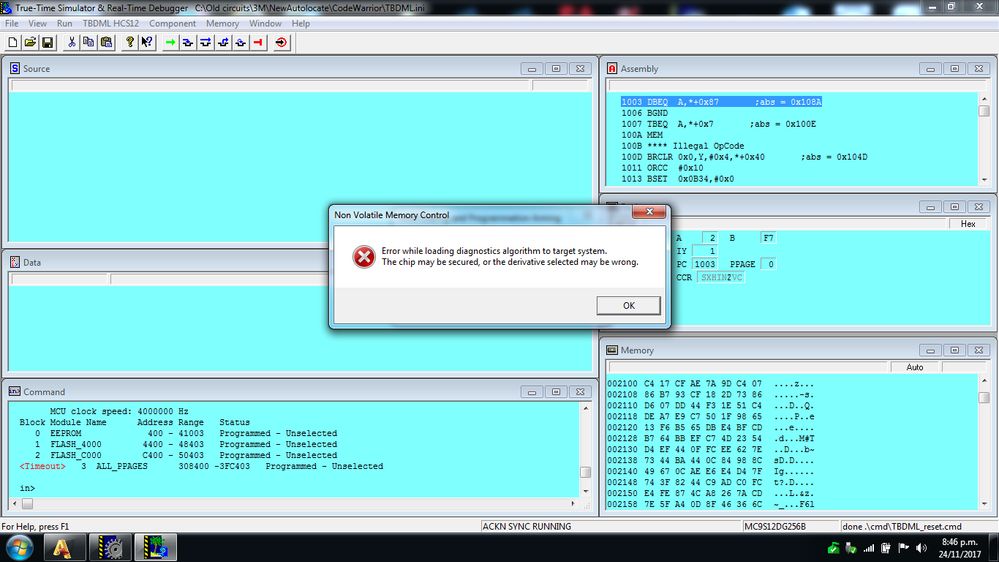

I have started a new project using a Thunderbird module, but I cant get it to program.
I get the error message shown in the attached file. I went back to some old boards from a previous project and they program fine, so its not Codewarrior or the USBDM.
Any ideas why I am getting this? For running with the USBDM, what should the switch settings be?
I've tried unsecuring the module, and Codewarrior reports success.Clipboard01.jpg

Just a followup. I changed the Thunderbird card and it programs fine, so its a fault with the Thunderbird card, or something about the processor.
