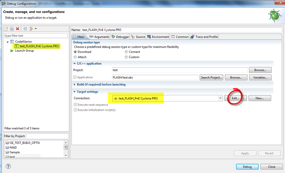

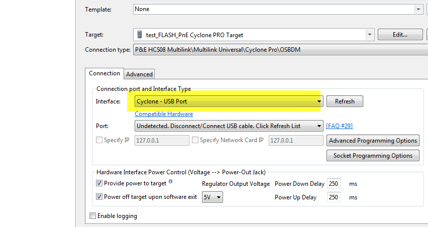

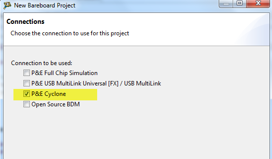

ZhangJennie
Hi.
When create a new project with wizard,choose "P&E Cyclone"
in debugger, choose P&E Cyclone as connection too
click on Edit button we can see interface setting
Jennie Zhang
