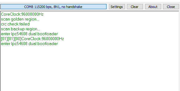

"Hold Wake-up button (7), and then press the RESET button. This forces DSBL to enter boot loader mode. In this mode,
DSBL does not boot any application, but waits for UART connection."
After doing this step as mentioned in demo steps in attached document , my device is not entering to bootloader mode .
bootloader COM port is not Visible in Device Manager.
have attached command window and serial terminal execution details for reference.

After you execute "Hold Wake-up button (7), and then press the RESET button. This forces DSBL to enter boot loader mode. In this mode,DSBL does not boot any application, but waits for UART connection.", you didn't see valid uart port in windows device manager?
if not, you need to check
- if your bootloader code is successful download.
- use this sequence  "power off the board, press wakeup botton, power on the board" to replace ""Hold Wake-up button (7), and then press the RESET button.". Can it fix the problem?
- if no, check the bootloader code in debug mode, can uart port work?

Deeps_bang
Hi Jennie,
I worked on demo steps  mentioned in document AN12327.
It worked fine with Wake up and Reset switch  assert.
But when i tried with Commands instead of Wake up its showing hardfault error.
Here i am attaching code for reference.
What am i missing??
Do i have to disable interrupts ??
