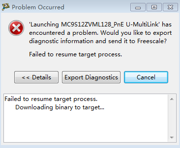

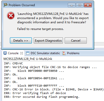

   When I use PE to debug a project based on MC9s12ZVML128 ,then the CW10.6 reported the problem:
and the detail information is:
I just add a LIN module into a project,and the LIN module is "FSL_LIN_2.x_STACK",but when i didnt do this,the project work well and can debug. but when i add the LIN module into the project, the problem occured.
So,what should i do?
Any help will be appreciated!

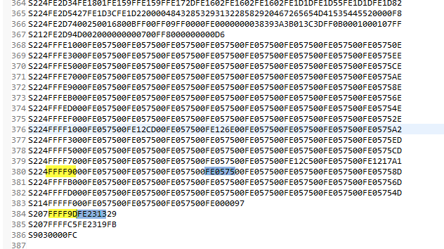

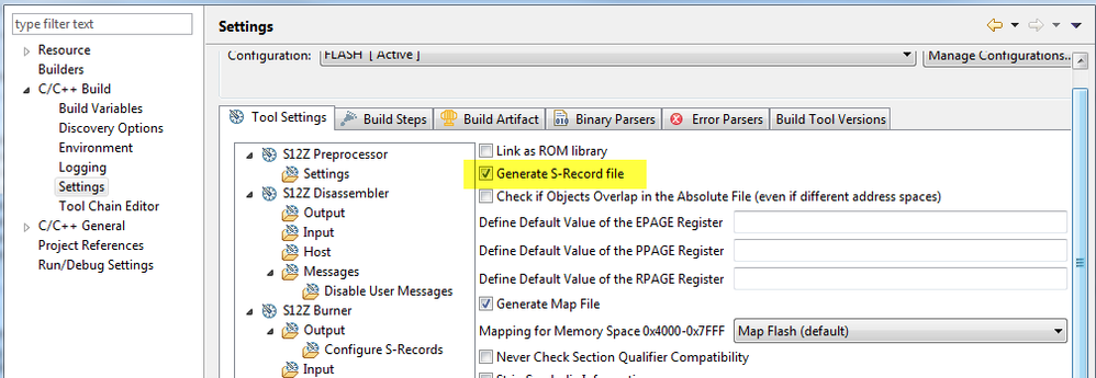

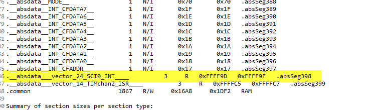

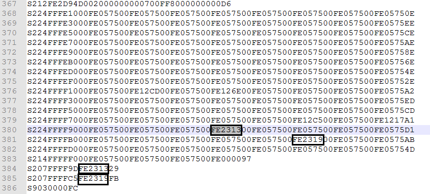

In order to test your problem, I enable srecord generation:
Then I found some conflict inside. For example. 0xFFFF9D is defined twice.
This address belongs to vector table, all the vectors are already defined in vector.c.
your extra adding files should include duplicated definition. check your map file like this
Please revise your adding file to avoid any code conflict.

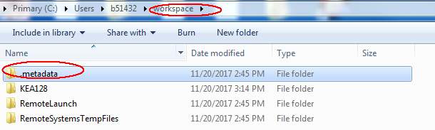

Hello Xiaofan,
How about delete the .metadata folder under workspace to have a try ?
If still can't , please share your project, I will test it on my side.

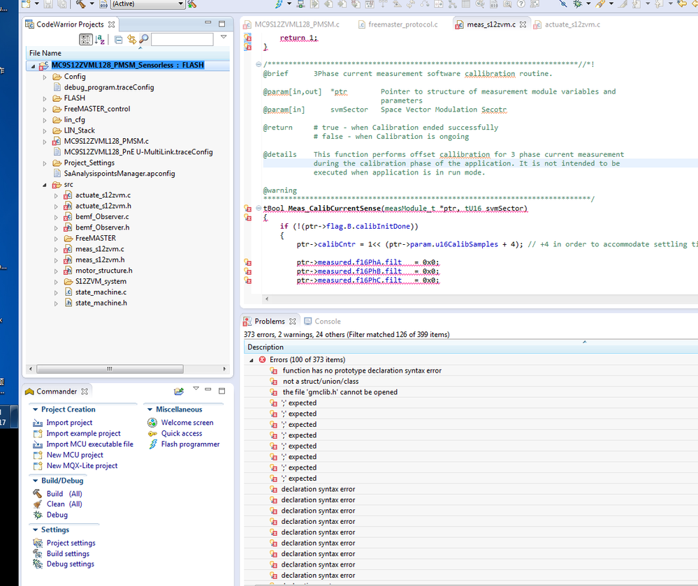

First,thank you for your suggestion,but it seems don't work on my side.So I attached my project at the end of my question.In my project,I only added two folders to the demo project "MC9S12ZVML128_PMSM_Sensorless".

Hello Xiaofan,
Sorry maybe there is  some lib needed when build your project,  it is error when build it.
I find a case the same error with yours :https://community.nxp.com/message/465762
Recommend you add code part by part, checking which part get the project can't downloaded .
Also check whether overflow.
Alice

    I'm sorry,because I loss to attach the AMMCLIB v1.1.4,so the project errors.I also attached the lib now.Please place the folder at "C:\Freescale\AMMCLIB\MC9S12ZVM_AMMCLIB_v1.1.4".
    In brief,I extract files from"MTRCKTSBZVM128_SW_V1.1.exe"which downloaded form NXP.com and it works well,then I add two folders "lin_cfg" and " LIN_Stack" , then the error occurs.
   Please give me some suggestion to help me to debug my project.

Hello Jennie,
   I just check my code,and I find the duplicated definition in my code. now, I fixed the code and my problem seems go away.Thanks for your time.

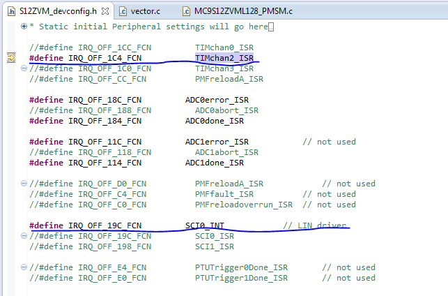

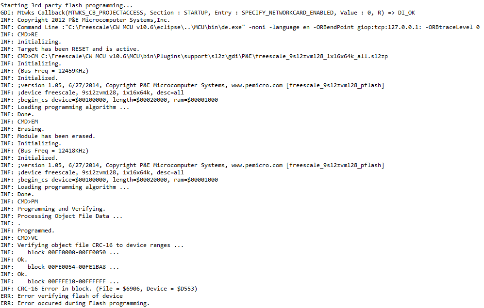

   According to the LIN stack,which downloaded from NXP.com,the LIN module uses sci0 and TIM2 channel,So,I should compile the "Slave_S12ZVML128.npf" and add two line codes :
   and now,the SRecorde file is:
so,is it right now? but the error still occurs :
what else should I check?
Any help will be appreciated.
