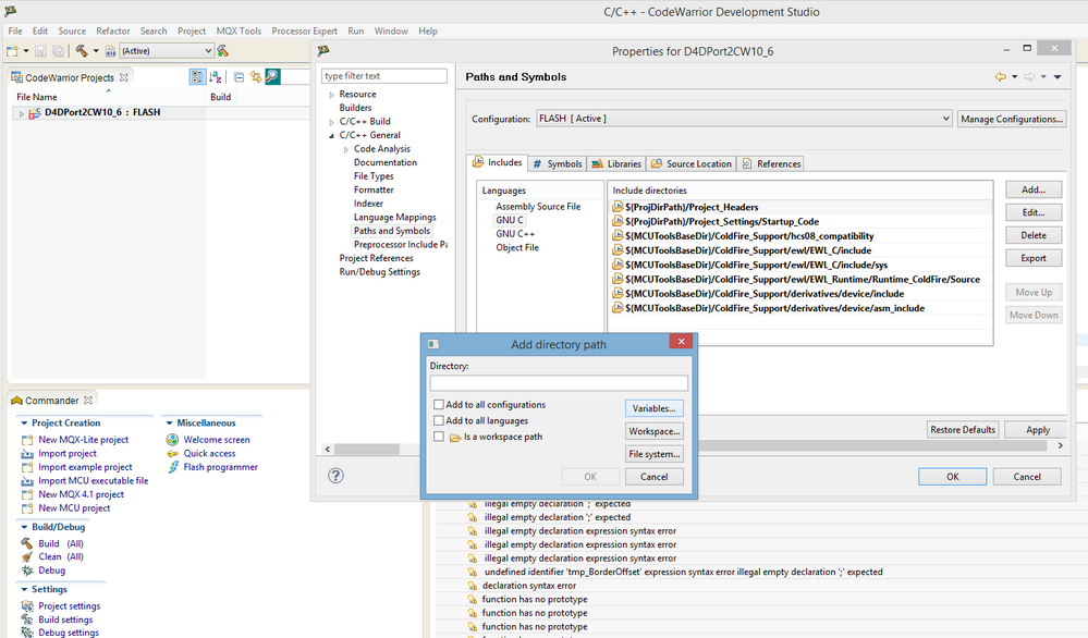

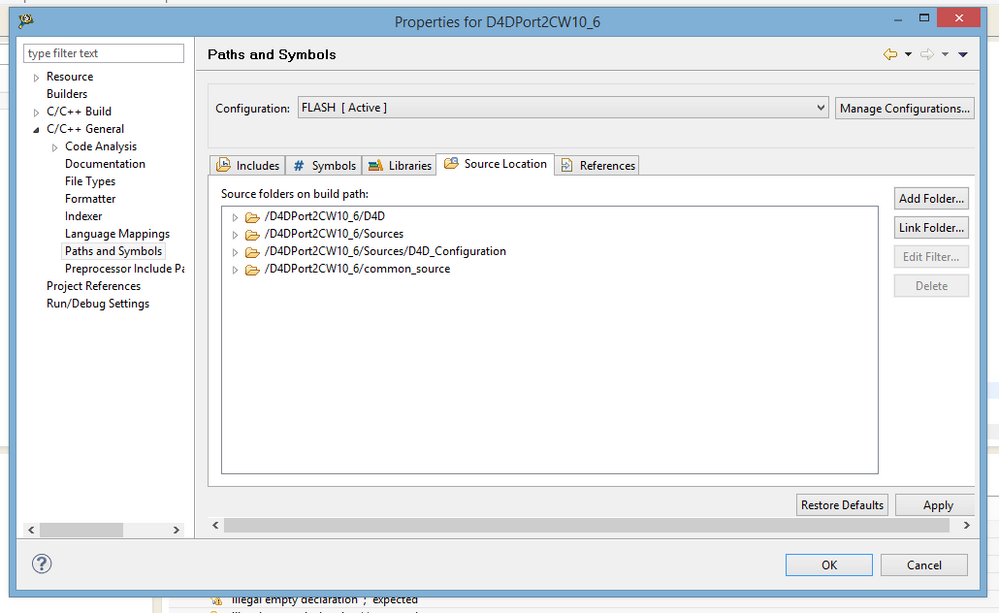

I have sample Codewarrior 10.6 Special edition (code limited) and the path statements do not work,  and the tool does not update properly.   If you start a project or try to port a project where the files are stored in different directories, THe path statements in the tool  "Project/Properties/C C++ General/Path and Symbols/   has both an Includes tab and a Source Location tab."    If I enter variables like ${ProjDirPath}/Project_Headers and other variables here and also on Sources tab put the directory </ProjectName>/Sources

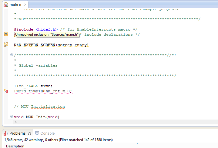

If I compile, I still get all kinds of errors like function has no prototype, illegal declaration, invalid project path.     WHERE I KNOW that this project works as the source files are coppied from an earlier working project, and I have confirmed that all the files exist in the same directory that are included in the Includes and Sources tab under the path and symbols tool.   WHAT GIVES?  is this because I am using the special edition?

Hello Jeff,
Do you mean add variables like this ?
If not , can you attach your screenshot about add variable on your project ?
Alice

jeff_sylvester
Yes,  I bought several TWR-LCD from freescale and am working on a project, but projects were done in Code Warrior 6.3 and now there is 10.6 so I am trying to port the files and compile with 10.6 but the path statements are not working.
I know what the problem is, the path statements are not working, I just dont know how to fix it, it appears there is something wrong with the tool.
If you look at the errors, they are all related to the fact that it cant find the files or the headers needed to compile.
For instance, I can compile all this stuff just fine in CW6.3 so there is nothing wrong with the source files,  the files are located in different directories
so it makes more logical sense to group certain files together.  So i just coppied the directories into the new CW10.6 workspace but the compiler
can not find them???
<project name> \D4D
<project name> \common_files
<project name> \Sources
<project name> \Sources\D4D_Configuration

Hello Jeff,
I see your need now.
1)  Porting CW6.3 project to CW10.6,  please refer to the application note (the attachment),  in the note is about CW 10.4, while it the same withe CW 10.6.
and when build have some build error , you can correct or conclude the file path .

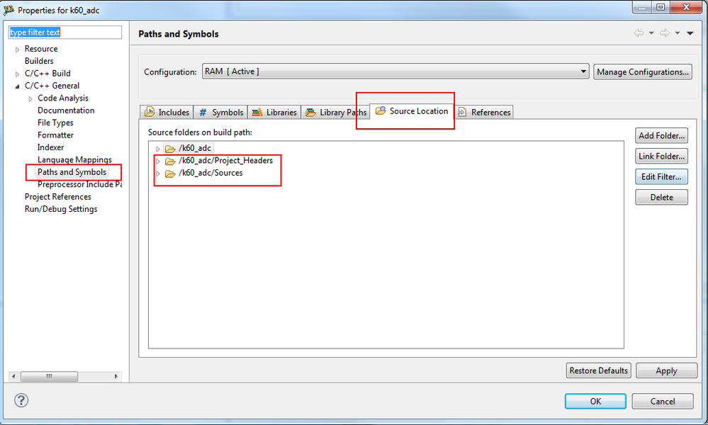

2) In the beginning there is some misunderstanding ,  if you want to include files the project is using , you should  include paths in here (see the screenshot)
Hope it helps
