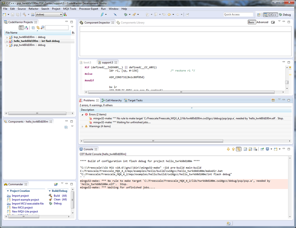

I just wanted to try out an mqx example drag and dropping its .wsd into the worksace.
(C:\Freescale\Freescale_MQX_4_2\mqx\examples\hello\build\cw10gcc\hello_twrk60d100m)
After cleaning all and compiling the entire project the following error occurrs:
mingw32-make: *** No rule to make target `C:/Freescale/Freescale_MQX_4_2/lib/twrk60d100m.cw10gcc/debug/psp/psp.a', needed by `hello_twrk60d100m.elf'.  Stop.
mingw32-make: *** Waiting for unfinished jobs....
Does any one has an idea what this is??

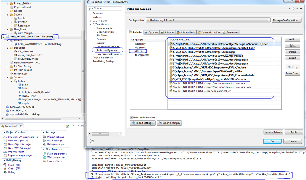

I made further test. I delete the generated code under <Generated_Code> and <Source> folder in project ‘bsp_twrk60d100m’.Then rebuild the bsp project.
I recover the settings for include path to the original configurations in project ‘hello_twrk60d100m’, and rebuild this project too.  It works well.
I attached these two projects.

Thank you Fiona!
Well, deleting all the generated code and also the sources even made it getting worse. But deleting the bsp_twrk60d100m and using that one you attached solved my problem!! YES!!! GOSH!! Well now I'm asking me why the reinstallation of code warrior and mqx didn't solve this!!? But this shouldn't be a further dicussion of this topic. I'm just relieved, that eventually it has an end!! This really was annoying!

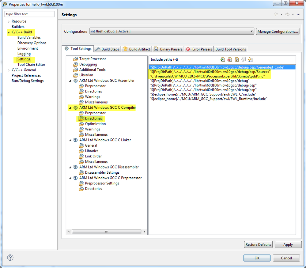

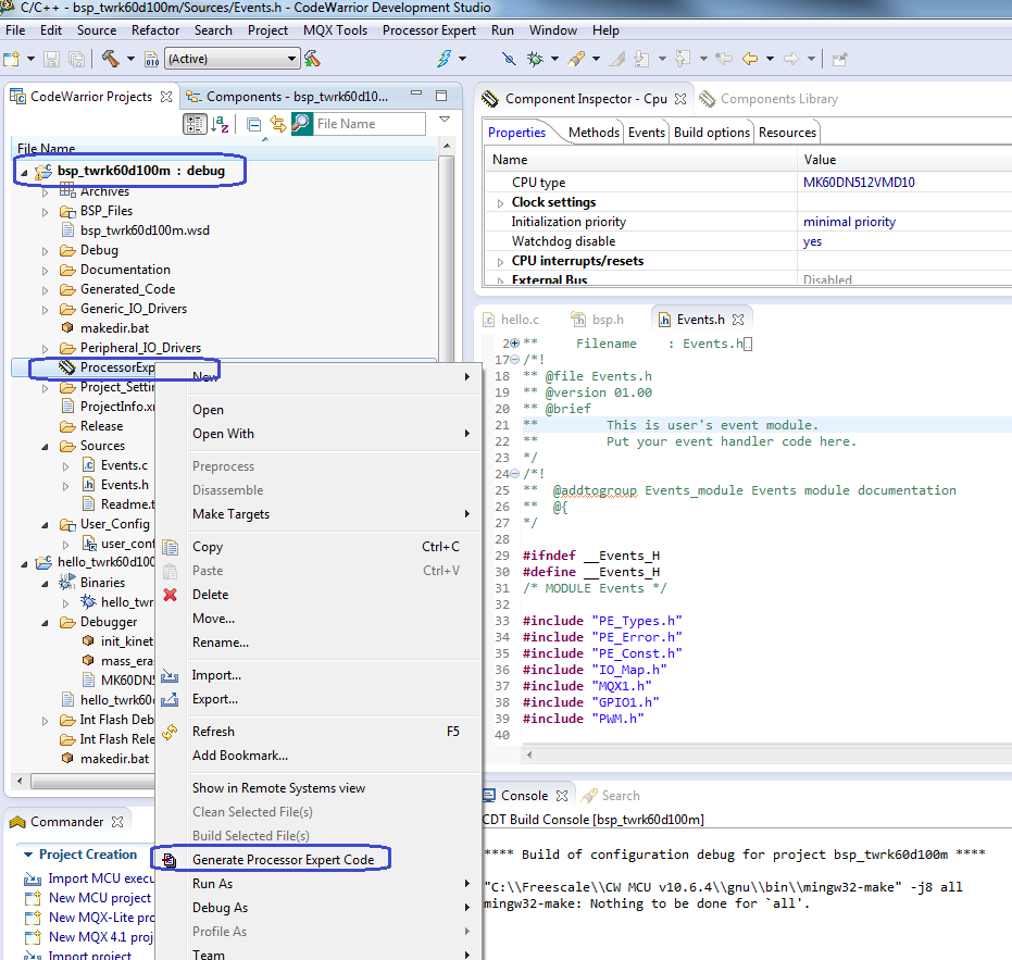

First,  please right click on the ProcessorExpert.pe in the bsp project, and  select “Generate  Processor Expert Code”, then rebuild the bsp project.
Second, in hello demo project, please add the search paths for C head files in Project Properties for unfound head files . I add three paths under MQX folder, please see the attached screenshot.
Then rebuild the hello project, I can successfully get the ELF output.

Please try adding these two include paths to your hello world project properties:
"${ProjDirPath}/../../../../../../lib/twrk60d100m.cw10gcc/debug/bsp/Sources"
"C:\Freescale\CW MCU v10.6\MCU\ProcessorExpert\lib\Kinetis\pdd\inc"
Let me know if it helps!

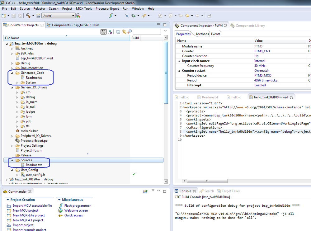

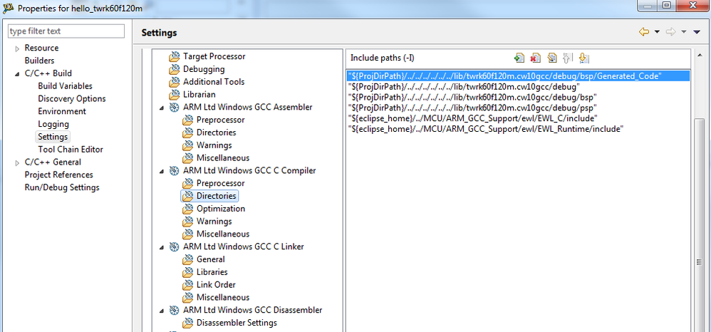

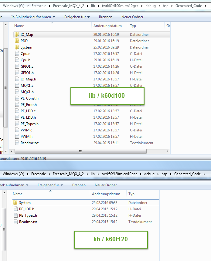

no this didn't help either. Another thing that may help to find the problem which is confusing me, trying to compile the same project but for an other hardware works well, and what I saw is, that for the k60d100 it generates a bunch of code and for e.g. the k60f120 or k21f120 it only generates a few files (see attached picture) even it is the same project and the hardware is not that different?! does that make sence?
And what about the issue I just mentioned before, that the path of the file, which the error message belongs to, points to a different path than where the generated code points to (and where the missing file exists, which the error message blames that it doesn't exist!)? Is this as it should be?
