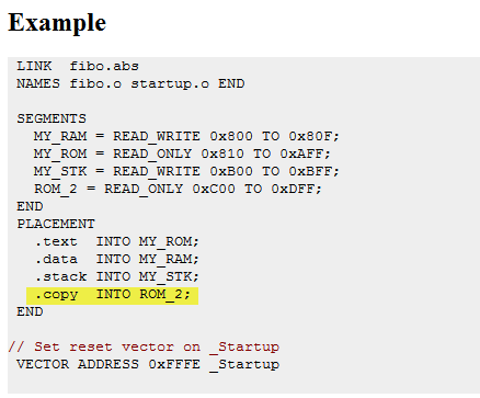

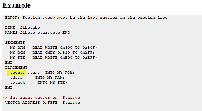

for example, this example will cause error. because .copy is not the last section
This is the correction: move .copy to the last section.
