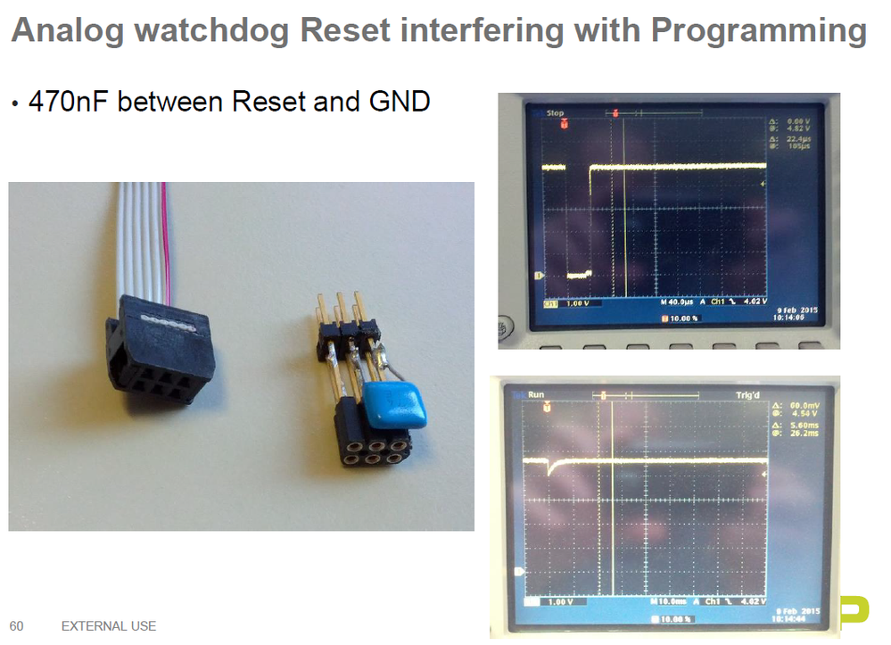

I have a kit9z1j638evm board. I can't download demo program with usbddm all the time. The prompt is BDM command ack missing.

Its probably an issue with the RESET. The Analog Die Watchdog might reset the device every 250ms (if not previously) disabled.
there are two proposals:
- open the S1-1 to disconnect the RESET_A from RESET (for programming)
 - or use a capacitor to "filter" the resets

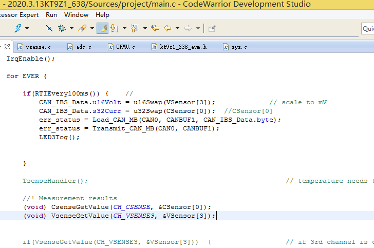

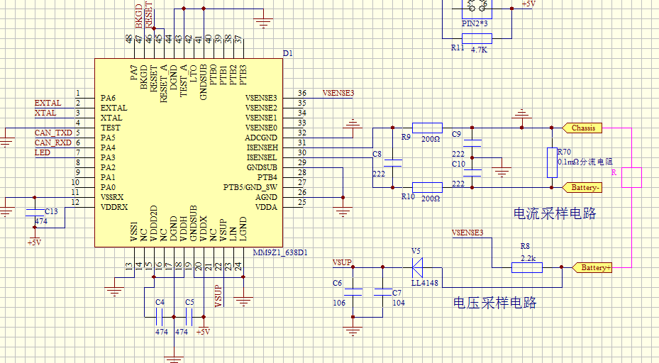

964839564
HI Diana,
Now,i use my board  to measure voltage and current,but its value are increase all the time.Is there something wrong with my schematic or my program(KT9Z1_638_CAN_demo).Design1.PNG
Thank you.
H YW
10,442件の閲覧回数
dianabatrlova
The issue could be related to your SW. Could you share your main.c?
The VSensor[3]  signal is NOT automatically VSENSE3 voltage.

for EVER {
if(RTIEvery100ms()) { //
CAN_IBS_Data.u16Volt = u16Swap(VSensor[3]); // scale to mV
CAN_IBS_Data.s32Curr = u32Swap(CSensor[0]); //CSensor[0]
err_status = Load_CAN_MB(CAN0, CANBUF1, CAN_IBS_Data.byte);
err_status = Transmit_CAN_MB(CAN0, CANBUF1);
LED3Tog();
temp++;
// TsenseHandler(); // temperature needs to be done polling (V,I interrupt driven)
//! Measurement results
(void) CsenseGetValue(CH_CSENSE, &CSensor[0]);
(void) VsenseGetValue(CH_VSENSE3, &VSensor[3]);

CAN_Wakeup(CAN0);
interrupt VectorNumber_Vcan0err void isrCANErr(void) {
CAN_ERR(CAN0);
interrupt VectorNumber_Vcan0tx void isrCANTx(void) {
CAN_Transmit(CAN0);
interrupt VectorNumber_Vcan0rx void isrCANRx(void) {
CAN_Receive(CAN0);
10,441件の閲覧回数
dianabatrlova
I'm very sorry for the delay. Have you solved your issue?
I'm discussing this with the expert on the MM9Z1_638
The SW seems ok.
  • TsenseHandler should be active, such that the device can perform compensation (needs to know the ITS = chip temperature)
  • Maybe you can enable the TsenseHandler and perform some measurements and send us that data?
Diana
