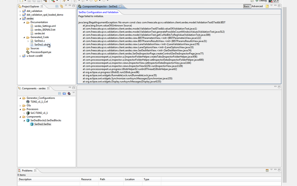

java.lang.IllegalArgumentException

Hello community,

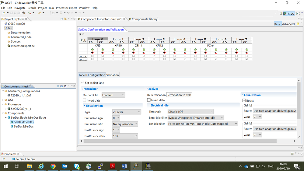

I can not display SerDes1:SerDes which is created with default Code Warrior QCVS SerDes Configuration Tool.
Can anyone tell me how to fix this error ? Is there any patch recommended to apply on latest code warrior for PA ?
I can not see a similar GUI referred in https://www.nxp.com/docs/en/user-guide/QCVS_SerDes_User_Guide.pd -1.1.4 Working with SerDes components - Figure 3.

Hello Yusuf Altıparmak,
I didn't reproduce your problem, SerDes tool works normally on my side. Please check QCVS version from Help->Install new Software->already installed ->QorIQ Configuration and Validation Suite, please check whether the version is 4.5.0.0001-20160210, if no, please download QCVS 4.5 from QCVS offline installation packages for CodeWarrior for Power Architectures Rev 4.5.zip - Google Driv... , and install this package from Help->Install new Software->Add->Archive.
