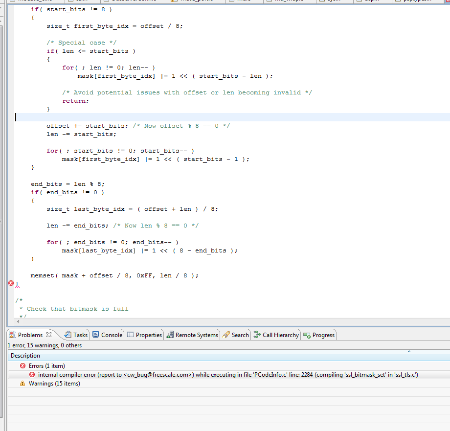

internal compiler error (report to <[email protected]>) while executing in file 'PCodeInfo.c' line: 2284

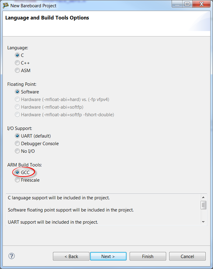

Thanks for the information. Is there a specific reason for moving to CodeWarrior? If you are early in your design cycle on Kinetis devices  then you may choose to move to the MCUXpresso IDE:
http://www.nxp.com/products/software-and-tools/run-time-software/mcuxpresso-software-and-tools/mcuxp...
Regarding the error, CodeWarrior has two compilers please make sure you selected the GCC compiler for your project which is the same compiler used by KDS:
Could you post the information shown in the console window about the error?
If you decide to use CodeWarrior I would also recommend you to use the latest CodeWarrior version which is 10.7:

munteanufani
Hi Carlos,
We have two projects. The latest is based on FRDM-K64 / KDS / MQX4.2 derived from an old project based on K60 / CW 10.2 / MQX3.8. We've frozen this old project to this configuration, but we want to keep upgrading after the new project flow. When porting the same libraries on both projects, the old K60-based project generated this error. Each change in this project (K60 / CW 10.2 / MQX3.8) generates additional costs: CW license, change to other versions of MQX.
Regarding at this error is attached a capture with last info from CW’s console.

munteanufani
Hi Carlos,
I’m used a development board from freescale FRDM-K64F.
CodeWarrior for MCU Version: 10.2, Build Id:120126
I do not use an example project. It’s a more complex project. When I added a new library, this happened. On KDS the project is built with no errors and works well. If you need more information, please let me know. I attached a desktop capture.
