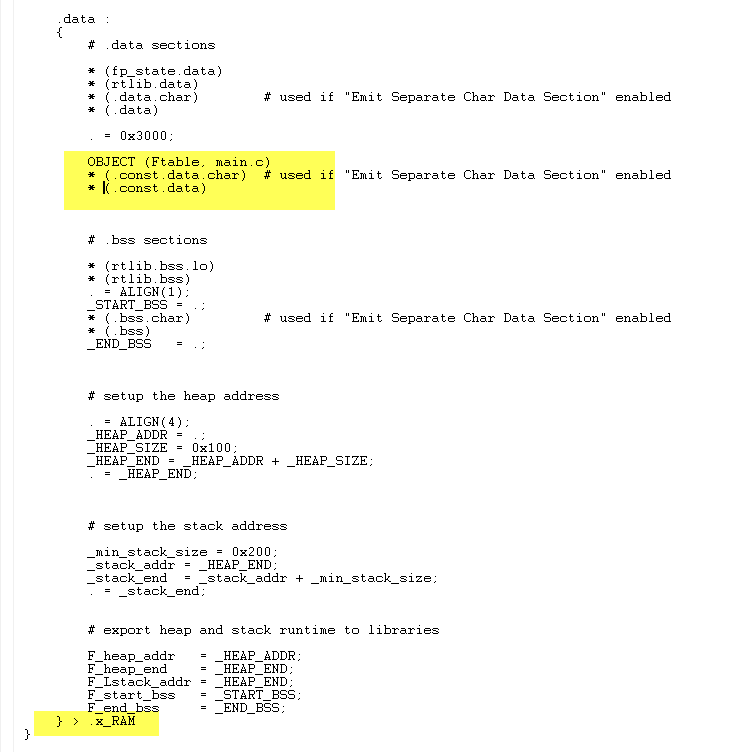

Sorry that I was tied up with other projects until recently. I looked into your sample project after linking, and found the two const arrays were placed in the  .x_RAM   section, instead of pflash ROM section. Why would one waste RAM space for const instead of using code flash ROM? The target is a 56F8367 processor with plenty of space for code memory. How would you do to assign these const (and any string constants such as in error_message="Motor is overheated!") to Code flash rom memory?

ZhangJennie
Hi Brain.
see this demo code *.cmd file, const data is defined in x_RAM. thus string "table" and "test" are allocated in x_RAM.
in your application, if you don't want const code allocation in x_RAM, please set it to the PFLASH or other ROM section that you want. This can distribute const data to ROM

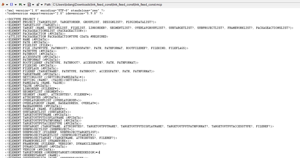

bdang
Hi Jennie,
I followed this instruction found on the old post of Fiona Kuang, and I was able to open your sample project:
"2) Or in your CW go to File->Import project Browse for the project location and set the "objects of" field to "All Files" Select the *.mcp file and click open Now in the window "Name new project as:" you should name your project and select Save. By doing any of the above you should be able to open your project."
Brian

bdang
Hi Jennie,
Thank you for the sample project but for some reasons when open the project *.mcp file, it didn't open properly. See below. What did I do wrong?
Brian

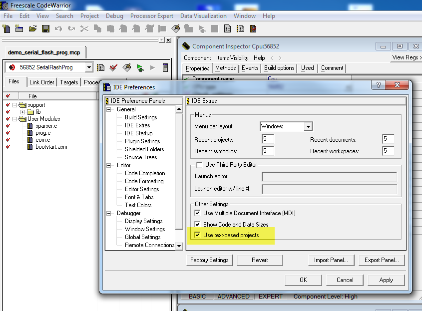

ZhangJennie
HI Brain.
Please open IDE menu "Edit" "preference", check "use text-based projects". then restart Codewarrior. import the demo project. it should work.

bdang
Hi Jennie,
I checked "Use Text based project" as instructed, then clicked on the project file *.mcp, but still had the same problem of opening the project. Might be I didn't read you correctly. You said "then restart Codewarrior. import the demo project. it should work."
You wrote "import the demo project" and so I also tried "File" , "Import Project", but there is no *.xml file to open.
I'm lost here.
