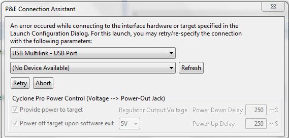

I tried to flash the demo board using Code warrior 10.5 but showing that "No device avaible" 9938_9938.jpgdebug.JPG.jpg
I successfully flashed the device using code warrior 6.3 classic IDE

Hello Pradeep:
The "No Device Available" indicates that your tool is not recognized. What programming tool are you using?
This is often caused by missing or corrupted drivers.
The next thread of our colleague Erich Styger will show you all about P&E drivers. Please give it a check and update your drivers:
Fixing the USB Drivers | MCU on Eclipse
Hope this helps!
/Jorge Gonzalez

pradeepkumar
Hello Jorge Gonzalez,
The article which you directed me to follow had solved my issue thank for your support
Pradeep Kumar
