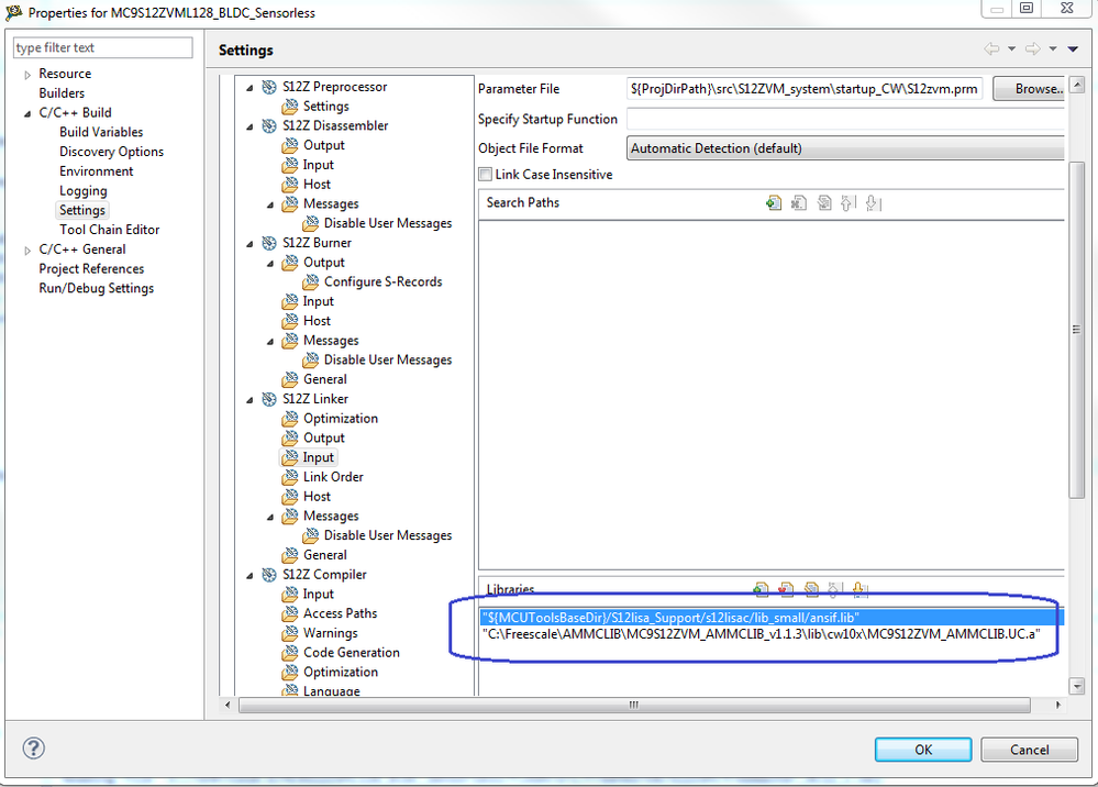

  I need to convert a floating point variable ram to fraction value for Using Fraction Lib
  float f_t1;
  tFrac16 test_frac1,test_frac2  ;
  f_t1=0.5;
  test_frac1 = FRAC16(0.5); // <--- O.K
  test_frac1 = FRAC16(f_t1) ; // Compile Err
How can i do ?

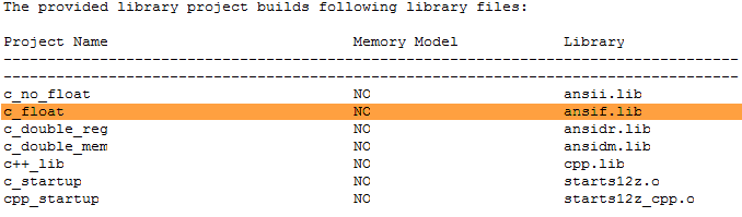

I built your project from my side, I got error message:
this is because symbols such as __fcmp are supported in floating library only. while this project use integer library ansii.lib which doesn't support symbols.
So Fiona is correct, change ansii.lib(c_no_float support library) to ansif.lib(c_float support library) can correct the problem.

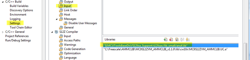

TICS_Fiona
Hello Ahn
Please choose the floating Point Library instead. Please open the Project Properties from ‘Project’ menu-> Properties. Then go to C/C++ Build-> Settings, under <Tool Settings> tab, go to S12Z Linker->Input,  please replace :
"${MCUToolsBaseDir}/S12lisa_Support/s12lisac/lib_small/ansii.lib"
With:
"${MCUToolsBaseDir}/S12lisa_Support/s12lisac/lib_small/ansif.lib"
I also attached a simple example project for using FRAC16 macro.

Hi Ahn,
for HCS12z library usage of, see below:
