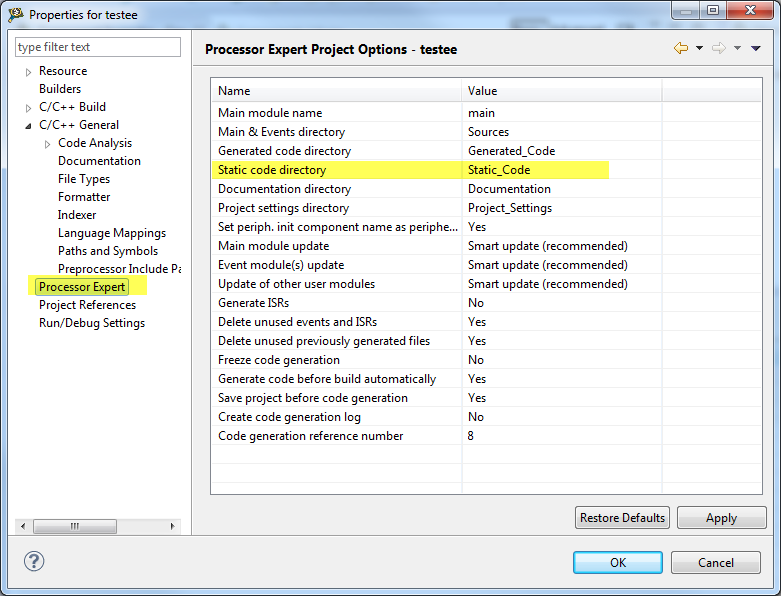

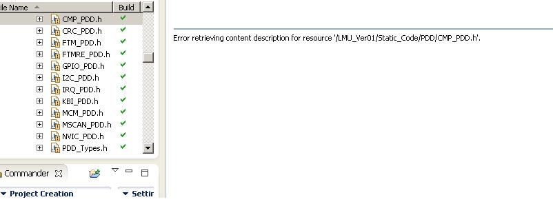

Hi, I sent my codewarrior 10.6.4 project(buit by PE) to my colleague, the static_code file can not be found when she opened it.
The path is wrong, it's still point to my workspace.
How to change the static_code path when the project opened by my colleague.
Thank you.
Jason

Hi Jason,
Static_Code is defined at Processor Expert Project  Option settings:
please check if your project is as same as my highlight screenshot.
with above setting, normally processor expert project can identify Static_Code folder well. if it's not on your side. I suggest you:
1. do menu "project", "Clean...".
2. click icon of regenerating processor expert code:
3. rebuild project. how does it work?

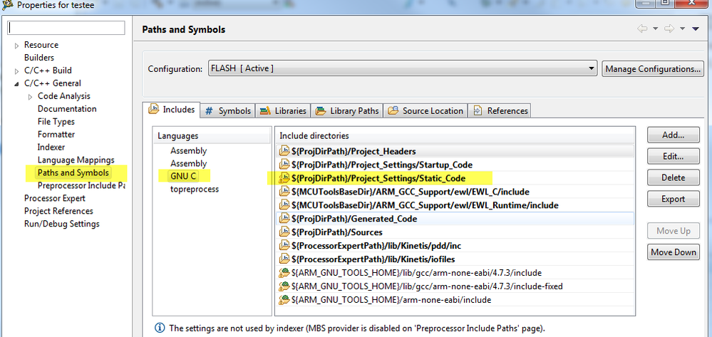

if above suggestion can not work for you, add Static_Code path to project properties:
can this help you work out the problem?
if not, please sent your project to me, I will look into the problem directly. thanks!

2,594 Views
jason_zhang
Hi Jenny
Thank you for your help. It works when my colleague did it as follow
2.click icon of regenerating processor expert code
Thank you very much!
Jason
