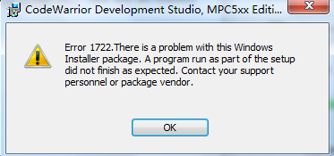

I failed to install "CodeWarrior for MPC5xx v8.7",tips are as follows:

I'm running Windows10 is there newer version I can install.

I have Codewarrior for MPC5xx v8.7, it can't be installed on Win10 32bit machine.  Do I need a new version of Codewarrior?  If so what version?

which operating system you use?
CodeWarrior for MPC5xx v8.7 is supported up to Windows XP. If you use some newer Windows operating system, it is not possible to install CodeWarrior into the one.
