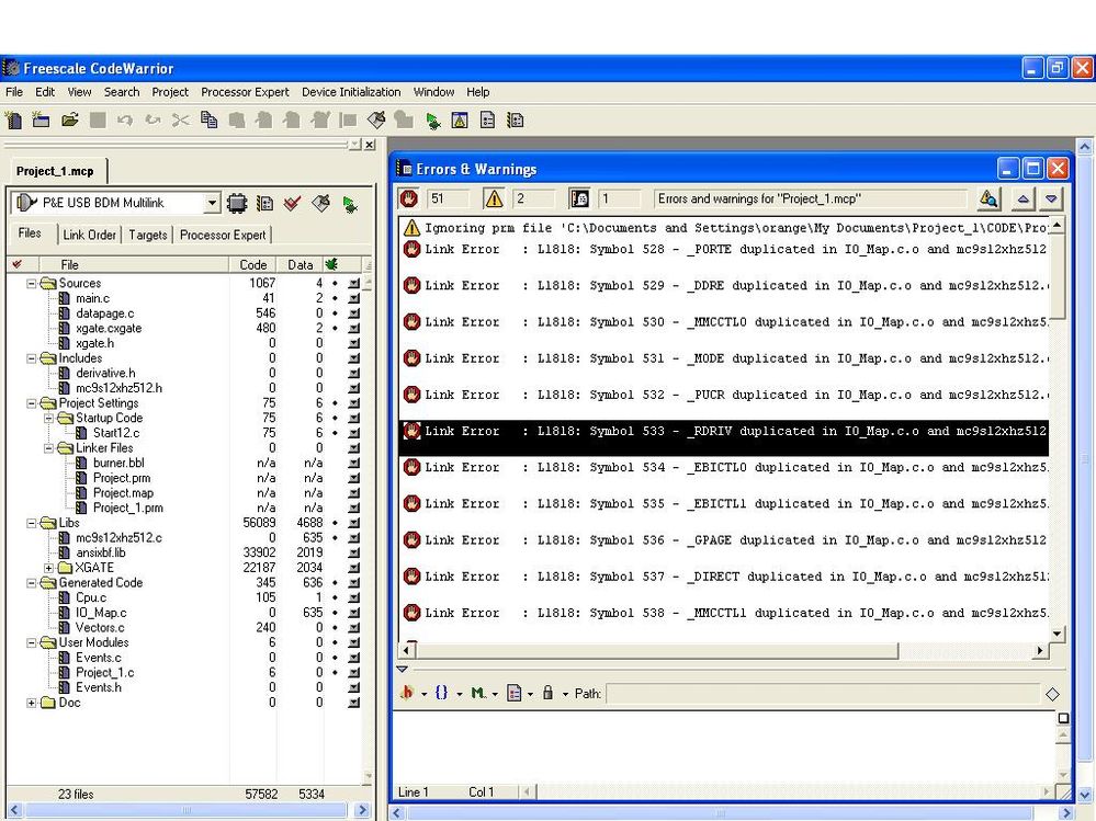

error while initialization of PE
1,669 Views
kdn
why this error coming when I am trying to use processor expert
1,596 Views
ZhangJennie
Hi KDN.
processor expert use its own generated header file IO_Map.c for MCU IO registers defination.
while NON- processor expert project use mcu header file such as mc9s12xhz.c for the same purpose.
because both of these two files are for MCU registers definition, they can't coexist in the same project.
I often see similar problem as yours when customer porting non-pe project to pe project.
if you use processor expert, please remove mc9s12xhz.c and mc9s12xhz.h from your project. this can avoid the conflict.
can this help?
