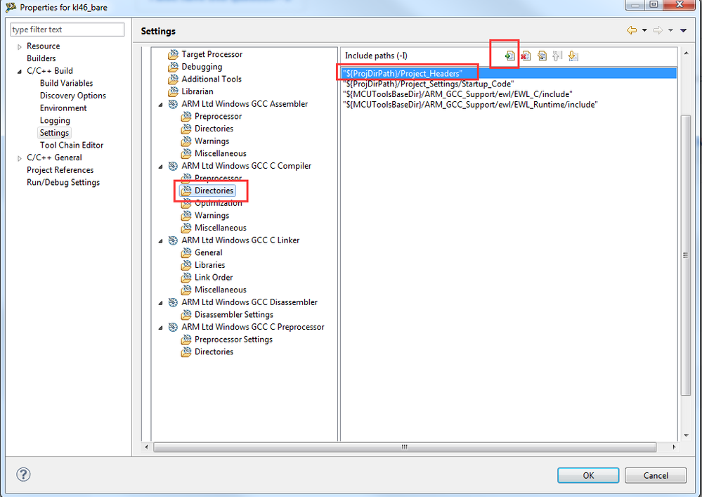

I have been given code that was created with CodeWarrior Processor Expert.  I need to create a project and import this code into my hard drive.
1. How do I go about doing this?
2. How do I configure the paths to be generic so that they will import the current location and add the subdirectories to the location?

Hello Harold,
- I reply to your second question at first, add the lib path at here:
- It is not easy for porting a PE project to No-PE project , maybe for the same register, they use different name.
So you need porting it step by step carefully.
What about your no-PE project , it is a bareboard or with other LIB ?
There is a tutorial about " Removal of Processor Expert for a Project ", maybe it can help you .
Removal of Processor Expert for a Project | MCU on Eclipse
Hope it helps
