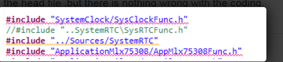

code warrior (V10.5) can not file the head file ,but there is nothing wrong with the coding.

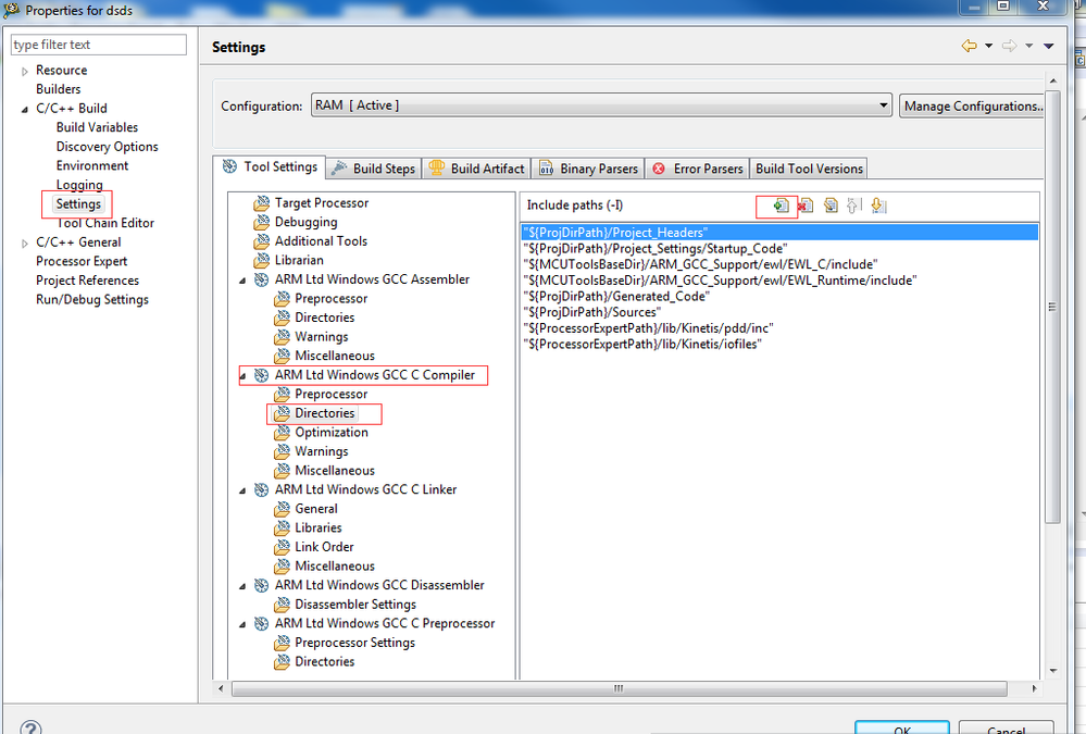

Hello ANDY,
So where are these header files ?
please add the path to Includes paths "
If still can not work well ,please take a screenshot about the error , also can send the project to me .
Hope it helps
ALice
3,153件の閲覧回数
andylong
Thank you very much for help, But I do not know to set the including path ..?
