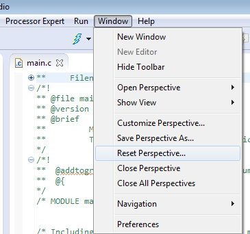

Could you try with the option Reset Perceptive in the window tab?:
 After this, select the show view in processor expert options
It should restore the processor expert view. Now to view the component configuration you just click the component. Sometimes when the windows shows nothing you can double-click the window's tab, it will maximize it and update the content, then you can restore it with the same method.

Thank you, Jorge. I am using CodeWarrior 5.9. I do not have those options. Any other tips?
