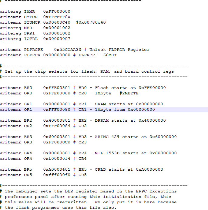

we are using mpc860tcvr66d4 for this we are using flash device S29alo16j55tfnr10 top boot sector (1M X 16) which is not there in the codewarrior 8.8 Ide so we added the device using FpdeviceConfig.xml and the device added which is showing in the Flash configuration. we are using my own Xml file, please go through it and see whether our base address is correct or not. we using Erase command which is showing succeeded. But when we are program the device it is showing flash base address error. Can you help in sorting the issue and help us finding base address. i'm attaching flash error ccs log and the Xml file which i'm using. Please help us.
my flash base address starts at  BR0=0xFF800000
                                                   OR0=0xFF800050
which is configured in Configuration and Xml file.

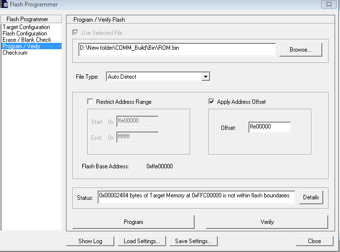

Pavel
Your base address is correct.
Do not "Apply Address Offset" if you want to burn your ROM.bin file at address 0xFFE0_0000.

Pavel
It looks like that "Flash configuration" is incorrect.
Check the "Flash Memory Base Address".
Flash programmer tries to use address 0xFFC00000 and this address is not within flash boundaries.

We are confused  how to find the base address for the FLASH ,we connected address lines AD30 to AD11 lines of the address bus . for that same we programmed the BR[0](0xFFE00801) and OR[0](0xFFE00080) . Now tell us what is the base address we need to for this flash address connections .

Pavel
Check your "<membaseaddr>0xFFE00000</membaseaddr>" value and Flash address in your .cfg file.

we checked the xml file and configuration file and changed my flash base address from 0xFFC00000 to 0xFFE00000 but still the problem is same.
we are able to access normal write and read operation in normal C code in debug version where we are getting ID of the device also.
my flash base address starts at  BR0=0xFFE00801
                                                   OR0=0xFFE00080
16- bit configuration.(1Mx16X1)
my Sram base address starts at  BR1=0x00000801
only code flash is the problem we are facing.

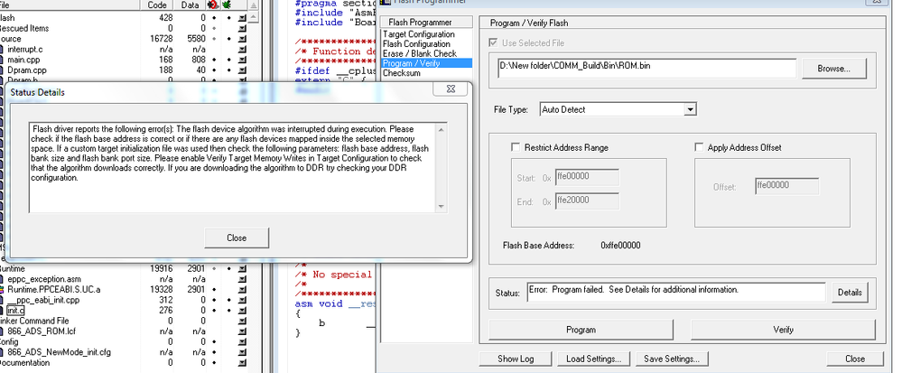

it is showing following error.
Please help with this
