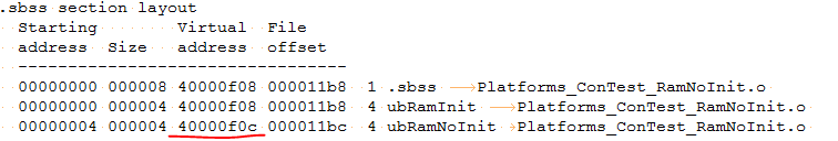

mahermalak
Hi b55689,
I have another problem that I am facing now.
I am trying to map a variable to given section that is defined in the linker file (attached before).
In my code, I have two variables, one declared normally and the second should be written in a given section (called RamNoInit, where after SW reset and during startup, the values of this section should keep their variables)
the declaration of the variables is :
The declaration of the section in the linker file :
   in Memory:
      in Sections:
In the generated Map file, we have the variable "ubRamNoInit" is not mapped in the correct section:
and the "noinit" section is empty:
Do you have an idea why i  have this problem ?
Do I declare correctly the variables ?
Do I need change something in the compilers options (attached) ?
Thank you
Maher

martin_kovar
Hi Maher,
it seems that linker garbage collector optimized your code. If you want to keep the unused variables in your code, you have to place this variables to FORCEACTIVE in your linker file. Please look at the example in the attachment.
Martin

mahermalak
Hi Martin,
The problem is resolved:
  • the declaration of the section ".noini" was false -> I should remove BSS
  • the declaration of the variable was false -> it should be : #pragma section sdata_type ".noinit" "noinit"
