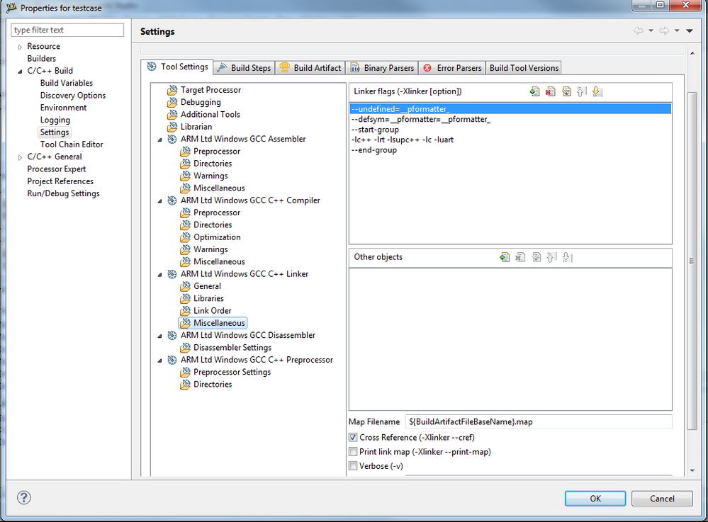

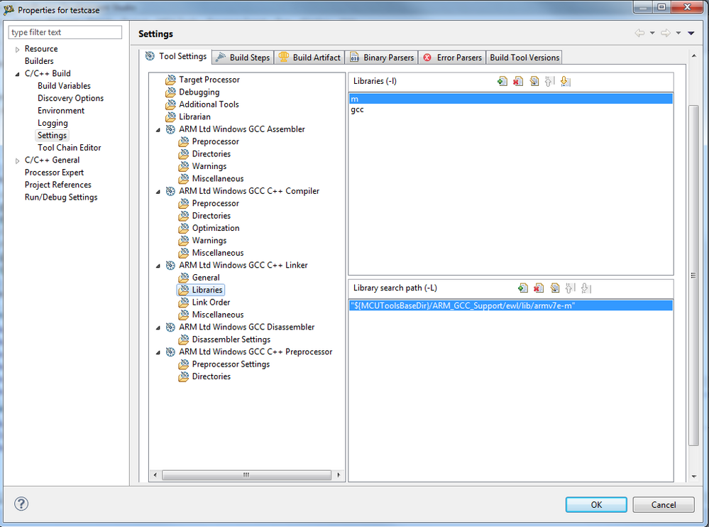

johnstrohm
One of our other guys found something.
__aeabi_d2iz lives in libgcc.a.
libgcc.a must be linked *AFTER* libm.a.
Adding "gcc" to the Linker | Libraries | Libraries pane after "m" fixed the problem.
We had a -lgcc in the Miscellaneous Linker Flags pane, which apparently caused libgcc.a to be linked BEFORE libm.a.

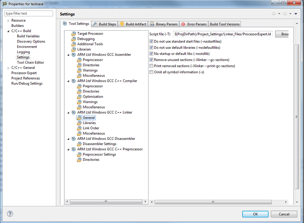

Carlos_Musich
Thank you for sharing the answer John.
May I ask you to share a picture of your linker settings? This way other members may find this thread very useful.
Carlos
9,298 Views
johnstrohm
9,298 Views
Carlos_Musich
Thank you!
