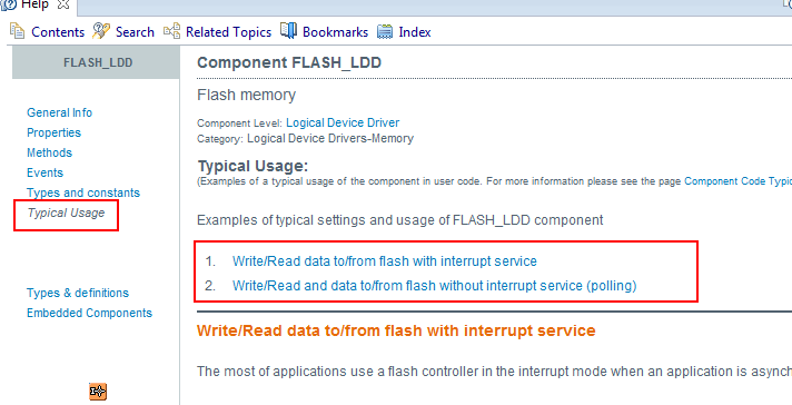

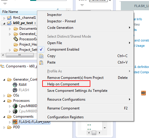

And also in the note of the function  , it has tell us how to use parameter of the function FLASH1_Erase() :
So, please use the second method you mentioned. Also you can refer to the "Typical Usage" of "help on component "

I'll confirm the detail in  the "Typical Usage" of "help on component ".
