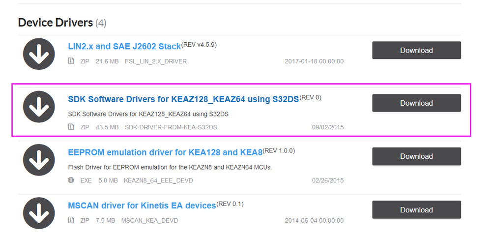

Dears,
We just started a new product development with KEAZ128, but quite confused by the supporting dev IDE...
NXP.com mentioned that both CW10.6/10.7, KDS and S32DS can be used for development. We are quite familiar with CW 10.7 and its ProcessorExpert, and we did confirmed KEAZ128 is supported by this PE. And NXP also announced that there is still no plan for KSDK 2.x to support KE family so far (MCUXpresso Supported Devices Table | NXP Community https://community.nxp.com/docs/DOC-333073), so we have some questions:
1, Does this mean we will have poor API/driver (KSDK 1.3?) support when using latest KDS/S32DS IDE?
2, What kind of SDK/driver and IDE recommended for KEAZ128 currently?
3, If we stick to CW 10.7 with PE, is there any possible restriction during future dvelopment?
Thanks in advance.

Hi Wang,
1. The KSDK1.x and 2.x are mainly support the basic kinetis products  K  L  series  , the KEA belong to
Auto group, not the same line. So there is a specific software for KEA.
2.There is a KEAZ128_KEAZ64 SDK drive using S32DS:
NXP Freedom Development Platform for Ultra Reliable Kinetis EA Series MCUs|NXP
3. As there is a driver for S32DS, so  you can use the S32DS , while you can also continue  using CW/KDS with PE, the existing function with PE won't disappear, also there is demo code under PE components.
Hope it helps
