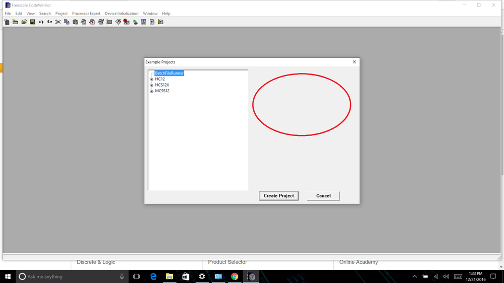

lymantsinnie
I had to reset my laptop and therefore had to reinstall CW v5.1
Since then, I am not getting the dialog for setting name and location of sample loads. I had sample projects that I wanted to load and run, it was working before the reset, but now i can't "name/location" any where. Repeated attempts at uninstalling/reinstalling prove same results.

Does Lyman,
Do you want this dialog :
If yes, please click File -> Startup Dialog...
Hope it helps
Alice Yang

lymantsinnie
Thanks for you help, but that was not what I was talking about. The areas where you name your project and location are missing. I had to reinstall and now when I open CW, those fields are missing.
I am running Windows 10. I have uninstalled, and reinstalled again but I still get the blank dialog. How can I completely remove CW? Would that be the issue?
Thank you!
3,384 Views
Hello Lyman,
The CW5.1 not support Windows 10 :
So now you only can test the CW v5.2 , it  support Win10, while it not directly includes the chip of
"MC9S12DG256 " , there is a method to add missing products on CW v5.2, you can have a try.
Add missing derivatives to CodeWarrior HCS12(X) 5.2 (Unofficial Method)
Alice Yang
