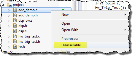

I'm looking for a way to create and view list files when building a project in order to see what the compiler actually did. Under project properties - C/C++ Build - settings - Tool Settings - ARM Assembler Output I set a tick to "Generate Listing File". But I can't find a .lst file anywhere in the project folder (see attachment). Is there another extension to these type of files or did I just overlook something?

Unfortunately with Freescale Kinetis build tools this is not possible, while it is with Kinetis GCC build tools. The only option you have is to view the assembly code source-by-source, by right clicking and selecting "Disassemble".
There is a compiler command line option which throws the assembly code to the console, but this is not really convenient. If you want to give it a try go to Project -> Properties -> C/C++ Build -> Settings -> Tool Settings -> ARM Compiler -> Language, and in the Other Flags box add the option -disassemble.

thank you very much for your answer! Using right-click and choosing "Disassemble" is exactly what we need!
