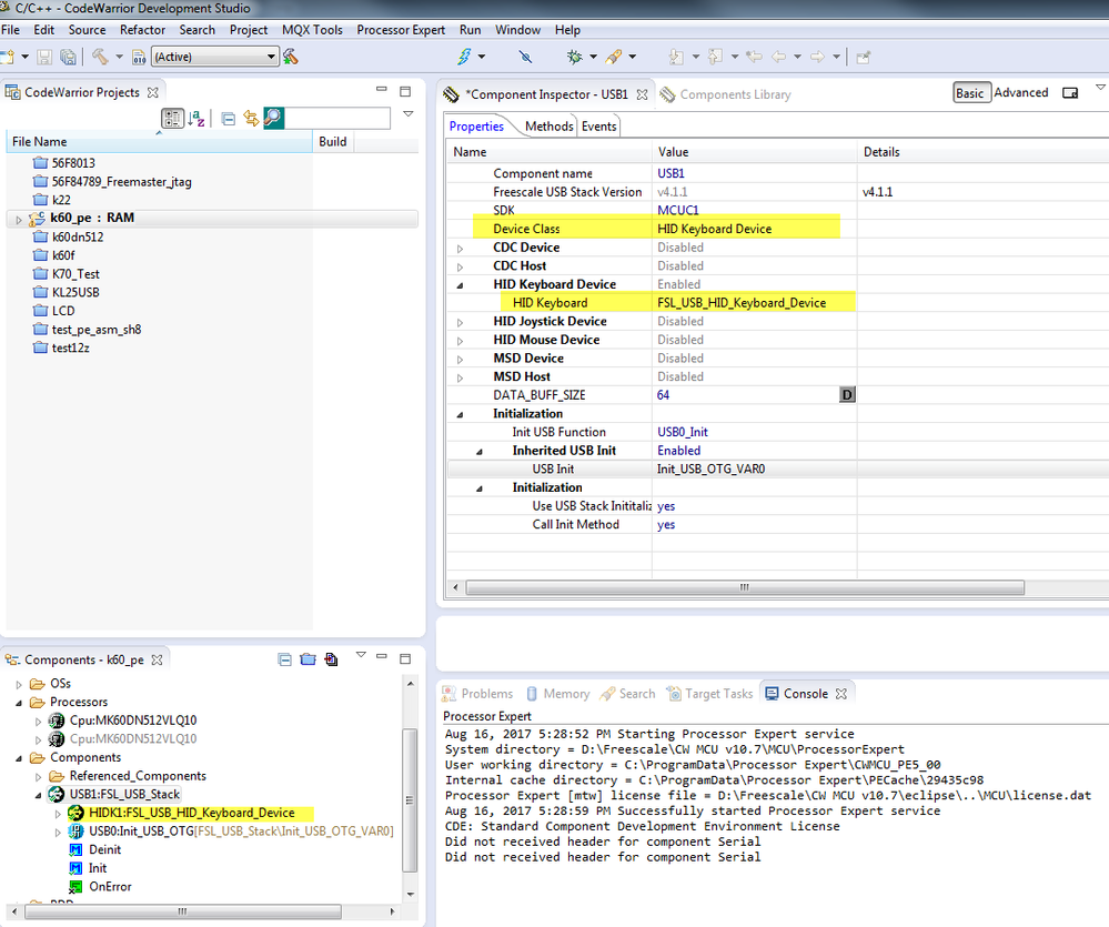

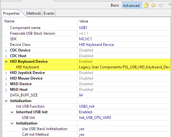

Hi Sandeep,

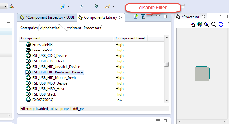

I downloaded the components from the link I provided ( Processor Expert Component *.PEupd Files on GitHub | MCU on Eclipse  ), FSL_USB_HID_Keyboard_Device is available. please try disable the filter and see if this component exists
when you use it, make sure you set device class as HID Keyboard Device :
How does it works?
