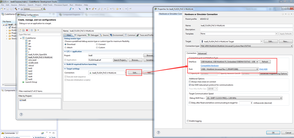

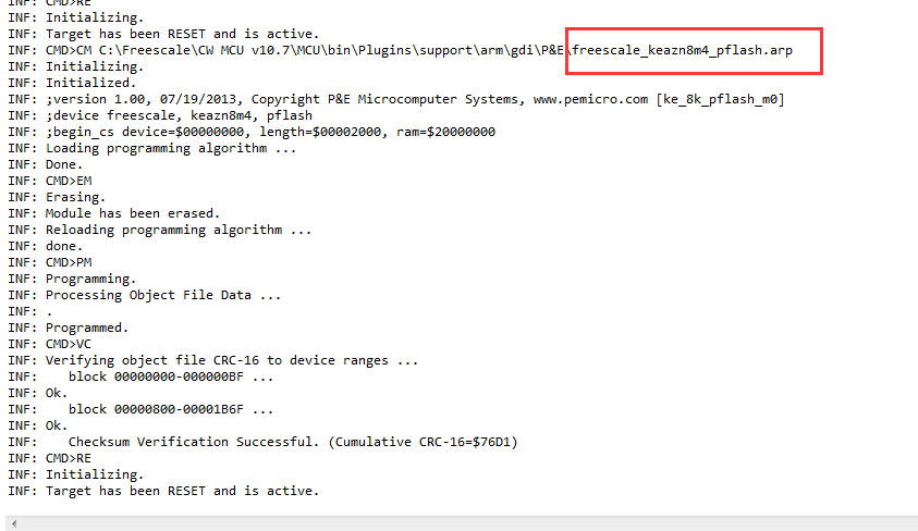

Hello Chad,
1. On the debug configuration , please check these place:
2.
From the log of console , it seems the board and debugger have connected correctly, it has erased:
INF: Module has been erased.
so please change to a new workspace, and create a new simple project, try to debug it .
3. Also check the program algorithm in console view :
