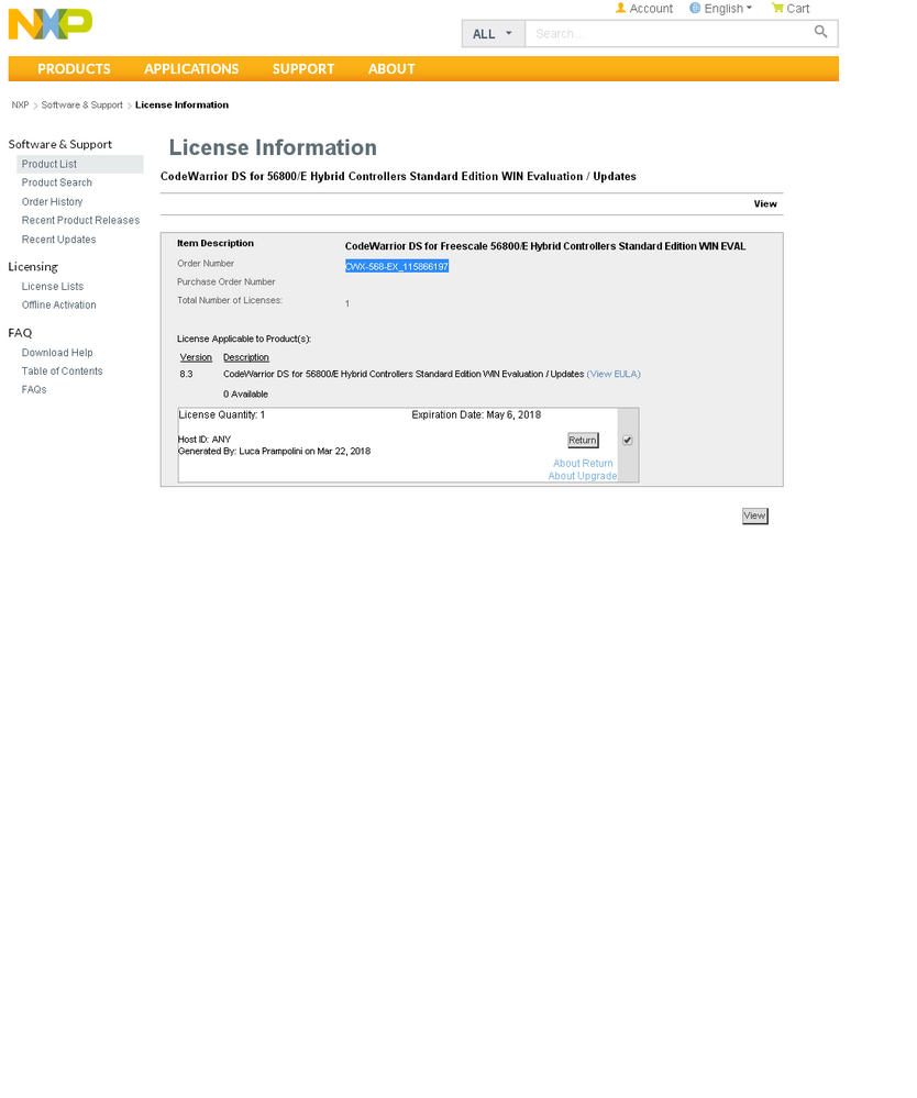

lucaprampolini
I've understood that is a codewarrior license problem. Now I' ve still downloaded  the evaluation version and I' ve a license until 6 may but it ask me already this license.Immagine.bmp

lucaprampolini
I've found the USB TAP driver, but I've the problem again...
The Jungo Windriver ask me to pay but it didn't never ask me before..

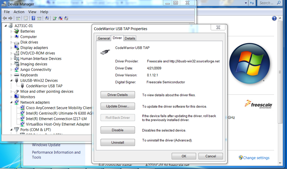

lucaprampolini
Thank you xiangjun, I think that the main problem is that  I don't have the USB TAP driver. Coul you send me a Codewarrior usb tap driver like in your picture?
Thanks again.

xiangjun_rong
Hi, Luca,
As I said that the usbtap driver is located at the directory in the CodeWarrior for DSP56800E ver8.3 tools, you can insatll the driver manually:
C:\Program Files (x86)\Freescale\CodeWarrior for DSC56800E v8.3\ccs\drivers\usb
Pls follow up the picture to install the usbtap driver.
Hope It can help you
