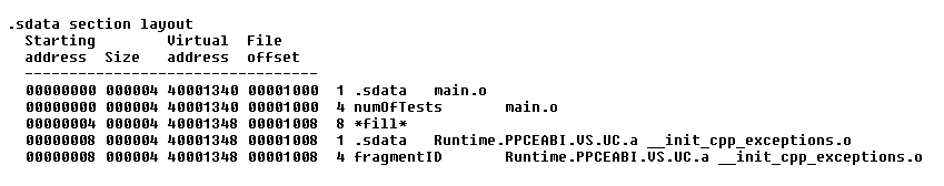

I have an initialized variable "numOfTests" that is mapped to RAM. As you can see in the attached linker file (XPC560XB_flash.lcf).
As it is an initialized variable, then it will be mapped to the ".sdata" section (small data with read/write permission).
uint16 numOfTests = 14;
So after flashing the ECU using a debugger, the value of "numOfTests" will be in ROM.
And to get the correct value, during startup, I need to copy that value from ROM and store it at the address of the variable "numOfTests" in RAM.
The variable "numOfTests" has an address "0x40000f08" as you can see in the attached map file (PA_XPC560XB_FLASH_ConTest_Standard.MAP).

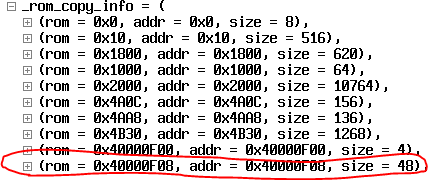

As I understood from the code, there is a table "_rom_copy_info" that is mapped to the section ".init":
__declspec(section ".init") extern __rom_copy_info _rom_copy_info[]; /* An array of all initialized (data, text or mixed) sections */
As i guess and I don't know how, but this table is generated by the compiler.
When debugging :
The table "_rom_copy_info" has wrong values.
As we see below the rom is equal to addr (ram)
having this case and the condition in the function "__copy_rom_section" :
if (size && (dst != src)) {
memcpy(dst, src, size);
__flush_cache( dst, size );
where :
  • dst = addr
  • src = rom
  • size = size
Then the values of section ".sdata" will never be copied from ROM to RAM.

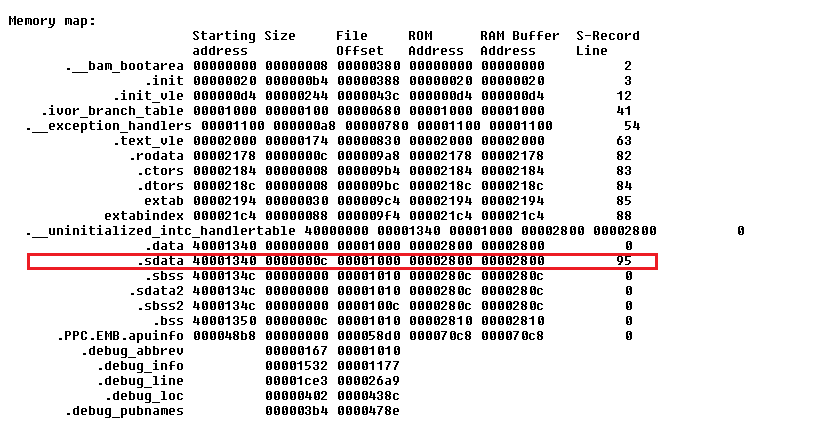

When you look at the map file, you should see that sdata in ROM are flashed at address 36b0.
I am sharing very simple project created in CW2.10 (default project), so please look at it and focus on the following points:
I have created global variable int numOfTests = 14;
This variable is places in sdata section, address 40001340.

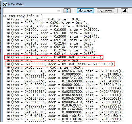

If you look at the another part of map file you should see following:
Section sdata starts at address 4001340 in RAM and at address 2800 in ROM.
Variable rom_copy_info looks like this:

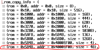

I opened your project and I saw that you are using the linker's flags : -rambuffer & -romaddr.
And I saw that you used the address of internal flash : 0x3000.
So i did the same and I put the init section outside of the group "mtextboot" and now I have the impression that the variable "__copy_rom_section"  has the correct values:
and at the address 0x5848 we can see the initial value of "numOfTests" 14 = 0xE
which is great.

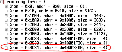

a section that shall not be initialized after reset (during startup) so the variables in this section shall keep their values before the reset.
this section is called ".noinit".
Problem:
But using the __init_data function, this section is also initialized !
This function uses the variable "_rom_copy_info" which is generated by the compiler.
And it adds the information of the ".noinit" section as well !
So it copies the data from ROM to RAM for this section!
And here is an extract of the MAP file :
.noinit section layout
Starting Virtual File
address Size address offset
00000000 000004 40003f00 00001694 1 .noinit Platforms_ConTest_RamNoInit.o
00000000 000004 40003f00 00001694 4 ubRamNoInit Platforms_ConTest_RamNoInit.o
What I tried:
I added BSS in the declaration of the section in the linker file:
    .noinit (BSS): {} > section_noinit /* RAM no init */
And in the source file, I defined a variable in this section :
#pragma push
#pragma section data_type ".noinit" ".noinit"
u32 ubRamNoInit;
#pragma pop
The variable is no longer mapped to the section ".noinit" but to ".sbss" and is always initialized.
