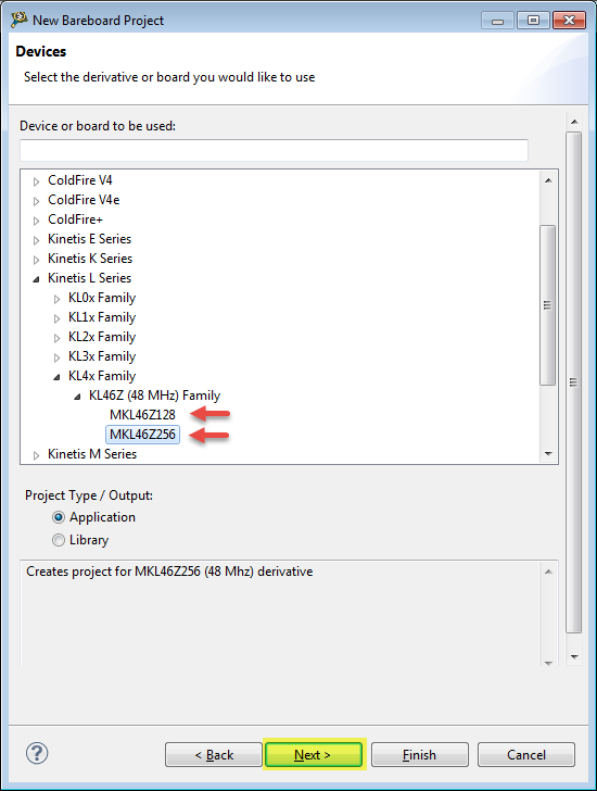

I am trying to create a new breadboard project with code warrior for my KL46Z , When I choose the Device the "Next" bottom stays off and does not let me go to the next step.Any one had this problem before? Also My chip is in the BOOT LOAD mode and I can see everything fine on Device manager under Jungo and Port.

Hello Maryam:
Under KL46Z there are two options and you have to select one of them. If using FRDM-KL46Z then you have to select the MKL46Z256:

Thanks Jorge,
I really don't know why it did not let me chose MKL46Z256 since there were no branches for MKL46Z ,I tried it today and it worked.:)
