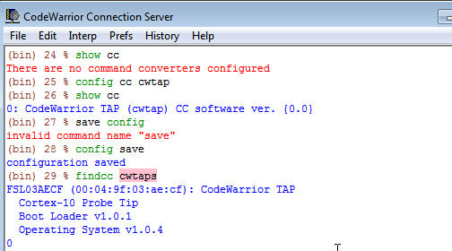

Greetings everyone,
I have a LS1021ATWR board which I want to flash using the CodeWarrior TAP probe.
I've installed Code Warrior Development Studio for Armv7 on Win7 x64
I have a problem when I'm trying to start the debugger on CodeWarrior:
The problem is, when i'm trying to launch ccs.exe manually, it can detect the probe:
I've looked into this: Can't connect CCS
and specifically:
I've tried writing these commands, and I don't have the same output, so I must think there might be some target connection error.
Here is my output:

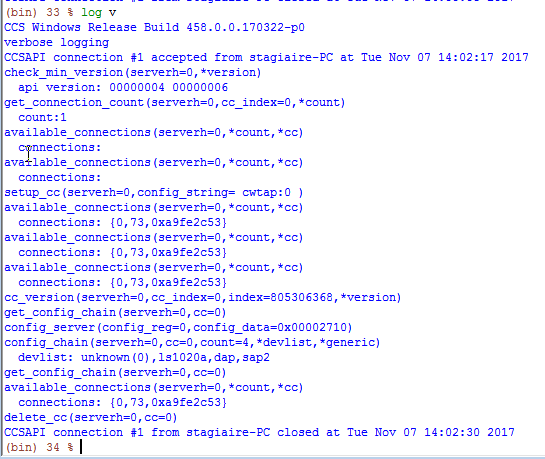

Here is what happens when I launch the debugger from CodeWarrior:
With log v :
It seems like a connection has been established and then immediatly closed.
I've conncted the probe on my host pc with the USB cable and on my target jtag pins.
I have to mention that my SWITCHES are on default configuration as on Getting Started Guide for LS 1021ATWR here: http://www.farnell.com/datasheets/2000257.pdf
When I power on the board, the LED D5 should turn off according to documentation, but it never does and it keeps lighting. The TX/RX of the probe is linking in a green color, but the RUN/PAUSE led is still in an orange color.
Any help would be apreciated.
Thank you,
Filip

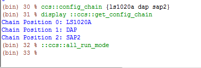

filipjabin
This is the output I received:
Note: After I do ccs::reset_to_debug, the D5 led turns itself off.
Filip

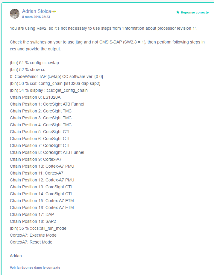

Hello Filip,
Please check whether you are using LS1021A 1.0 processor.
In the CCS console, please run "source IDcode.tcl" to get more information.
If you are using reversion 1.0 CPU, please refer to the following procedure.
To debug a target with this processor revision you must use the CFG file "LS102xA_Rev1_ConfigChain.cfg" that can be found at the location
[CW install path]/ARMv7/ARM_Support/Configuration_Files/jtag_chains/. This file will be imported following the next steps:
1. Open "Debug Configurations..." and select your project;
2. Click on the "Edit..." button which can be found next to the drop list called "Connection" from the "Target Settings" view;
3. Click on the "Edit..." button which can be found next to the drop list called "Target";
4. Click on the "Edit..." button which can be found next to the drop list called "Target type";
5. Click "Import..." and then "File System..." and select the file specified above and then click OK until you return
to "Hardware or Simulator Target" window;
6. Select in the "Hardware or Simulator Target" window the initialization and memory files from the project;
7. Click OK until you return to "Debug Configurations..." window and click "Debug".
