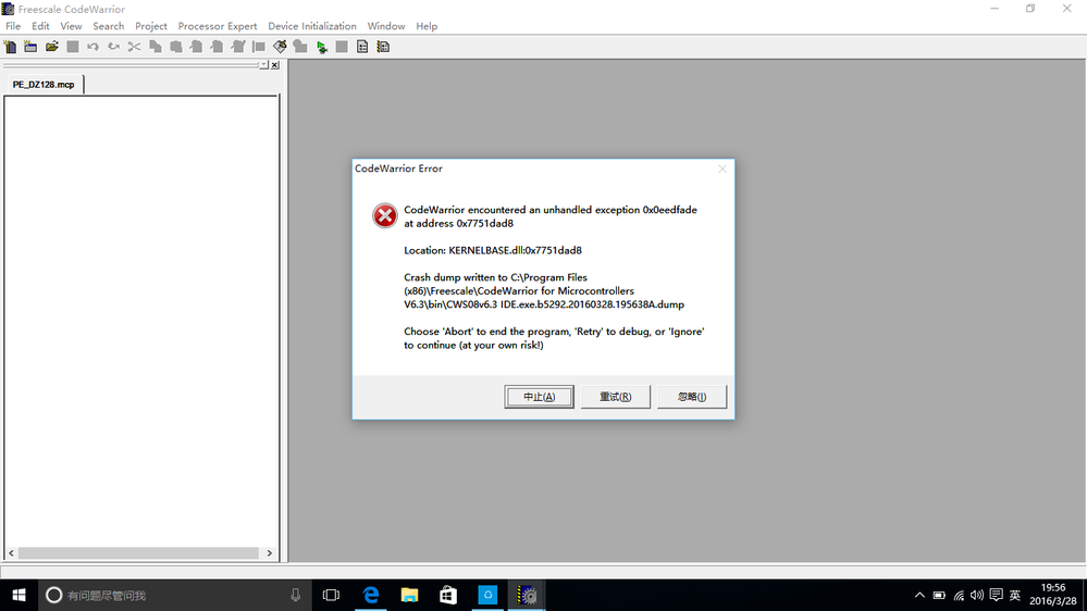

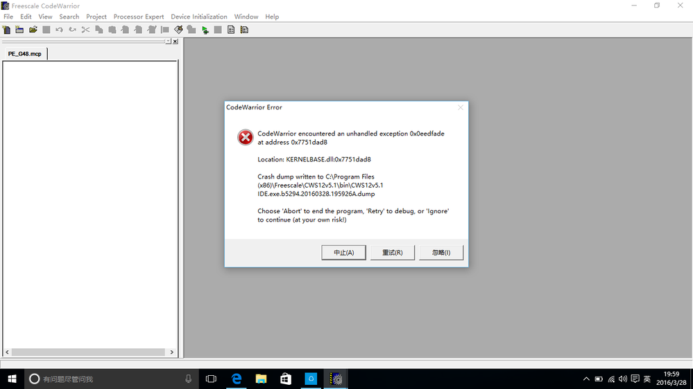

The codewarrior will show error when I close the project of using processor expert. The codewarrior is normal if I don't use the function of processor expert or I used the processor expert in windows xp sp3 .my system is windows 10 ,64bits, x64 .

what MCU do you work with?
Officially CW5.1 doesn't support win10. while CW5.2 does.
CodeWarrior Dev Tools for HCS12(X) MCUs|NXP
CW5.2 can support:
    - MC9S12C128, MC9S12C32, MC9S12C64, MC9S12C96
    - MC9S12G128, MC9S12G96
    - MC9S12GC128, MC9S12GC16, MC9S12GC32, MC9S12GC64
    - MC9S12GN16, MC9S12GN32
    - MC9S12P32, MC9S12P64, MC9S12P96, MC9S12P128
    - MC9S12XEP100, MC9S12XEP768
    - MC9S12XEQ384, MC9S12XEQ512
    - MC9S12XET256
    - MC9S12XS128, MC9S12XS256, MC9S12XS64
    - MC9S12VR16, MC9S12VR32, MC9S12VR48, MC9S12VR64

MC9S08DZ128
MC9S12XET256
CodeWarrior for Microcontrollers V6.3 and CWS12v5.1 can work in windows 10,
if you setup the software in windows xp sp3, then you copy it to windows 10, and save it to directory "C:\Program Files (x86)\Freescale".
you need run "regservers.bat" . but the processor expert can show error when you close project, if you create project using the function of processor expert .
the solution come from NXP Community, https://community.freescale.com/thread/302974
Hi Eugenio,
The CW for MCU V6.3 installer is not running on 64 bit OS.
The installer is checking the OS version and will not run under 64 bit.
To be running you must install the tool 32 bit system.
However under Win 7 64 bit you can install the tool on 32 bit system and copy the installation folder to Win 7 64 bit.
After that you can execute \bin\regservers.bat before to launch the \bin\ide.exe.
I've checked on my Win 8.1 64 bit and the process is working too
You can get error when the \bin\regservers.bat is executed and an error when you try to launch the IDE.
In this case you must:
-> open a Command prompt in administrator mode,
-> go to \bin folder,
-> execute regservers.bat
Now the IDE will be correctly registered

RodneyMcGee
For ProcessorExpert crashes using CodeWarrior 6.3.
How-to Directly Install CodeWarrior 6.3 Classic in Windows 7 and 10 x64 (Unofficial Method)
There is a fix.
See the PE_Plugin.dll fix under the Main Installation steps
