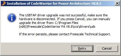

I'm trying to install codewarrior on my win7 64 PC, I recently posted getting some help regarding installing CW on another PC and got the following replies which were very helpful.
     https://community.freescale.com/thread/329298
So that got us up on running on both Windows XP and Windows 7 which we needed.
However I've now tried to reproduce this setup on my own Windows7 64 development box. However it was not a success (it connected and talked to the tap but gave some other error which I now forget) but during this process I decided to uninstall and repeat my steps to make sure I took the correct patches etc etc.
However when I now try reinstall I get the following error....

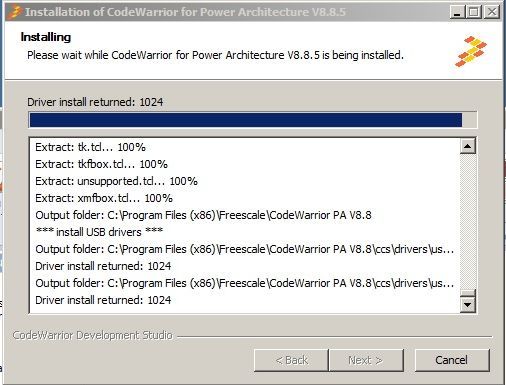

In addition the installation window has the following in it
The same steps seem to have worked elsewhere so is this a 64 bit windows problem or is it something else...
thanks in advance
regards
Craig

Tou can try to follow the steps from ccs\drivers\ccs_drivers_installation_help.txt.
Adrian

Thanks Yiping for your advice, however I definitely did not have the device plugged in during this process.
I did however have another device plugged in, I wonder if perhaps that confused the installer somehow?
I'll try with absolutely nothing plugged in.
Thanks for your reply.

Thanks Adrian
Followed the uninstall steps for the USB driver and all is well again, at least on the install front. Now I need to see if it'll talk to my target!! but that's another story.

Hello Craig,
Please note don't plug in USB TAP during CodeWarrior 8.8 or any patch installation.
I think probably that is the cause.
