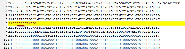

I  fail to use  SRecCvt  for  formating a  S12G128 project.abs.s19 ,the error is
"S-record data not in specified memory map"
The application program prm file and project.abs.s19 file are  attached.Where is the problem?
2 返答(返信)
1,725件の閲覧回数
ZhangJennie
HI YuWu,
This error message means that the tool detects the memory address in your input s19 file doesn't match the product memory map definition.
I checked your s19 file, seems there is one line of code abnormal. See below I highlighted:
Here, "C167" is defined at address at 0x8000. However, 0x8000 TO 0xBFFF is used in banked as you defined in prm file.
For test, if you delete this line 6: S1058000C16752
Save file.
SRecCvt should be able to convert s19 file successfully.
