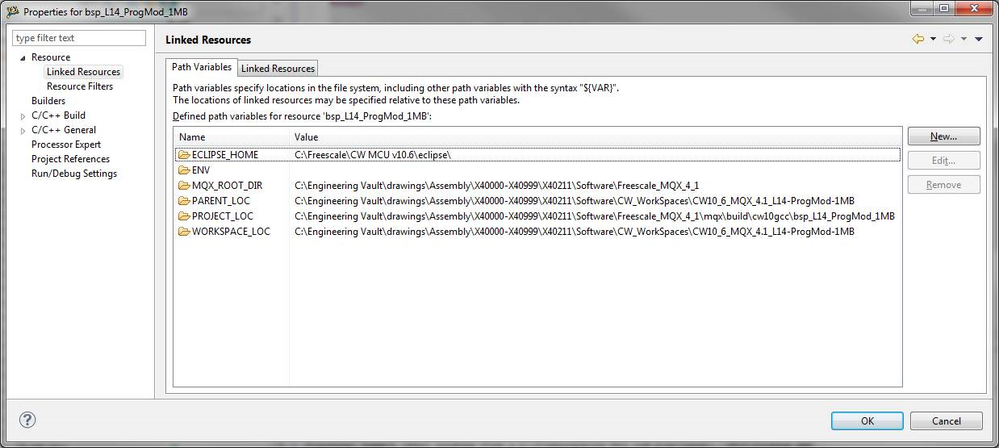

My company recently performed an upgrade to the drive where I keep the MQX install and CW work spaces. After the upgrade was complete and I could reconnect my projects would no longer build. I tried making a new work space but that hasn't fix it. They did make a slight change to the directory path replacing an underscore "_" with a space( “C:/Engineering_Vault/” changed to “C:/Engineering Vault/"). I suspect this is where most of my issues are coming form. I have corrected the paths in Linked Resources but still have an issue.
Anyone know what might be wrong here?
Sean
Below is a screen shot of Linked Resources and the errors I'm getting.

6,824 Views
BlackNight
Yes, that's the issue.
The compiler reads the -D option, and stops at the first space, then it reads the next item as a file to be compiled (which is of course not found).
Go to the compiler project settings, and have that path name in double quotes (preprocessor defines).
I hope that helps and cures it.

seandema
I turned off parallel build, did a clean, and deleted the make file output folder ('Debug' in my case). However that has not resolved the issue. I'm still getting similar build errors though the output is more clean now.

BlackNight
It looks the bad thing is in the file "Sources/Events.args"? Can you post its content?
Erich
6,824 Views
seandema
Here are the contents.
I noticed the line starting with "DMQX_ROOT_DIR" doesn't have its path in quotes. Do you think that's the issue?

BlackNight
Erich
6,824 Views

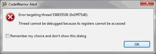

seandema
Thanks! That was the issue.
However it was recommended that I go ahead and move MQX to a different location after all. I went ahead and re-installed MQX to a different location, and re-cloned and configured my BSP. I can build just fine but now I get an error message when I try to debug. Any chance you know what this means?
Sean

BlackNight
Sean,
This seems to be a problem reported by the MQX kernel aware plugin. Can you try to disable it in the debug/launch configuration settings if it makes a difference?
Erich

seandema
Tried turning it off. Initially it would just stop in dispatch.s and refuse to run instead of showing the error message. I rebuild my code and then it ran just fine. After that I tried turning the kernel aware stuff back on and now its running with it on. I can't explain it but I'm glad it's working.
Thanks for all your help.
